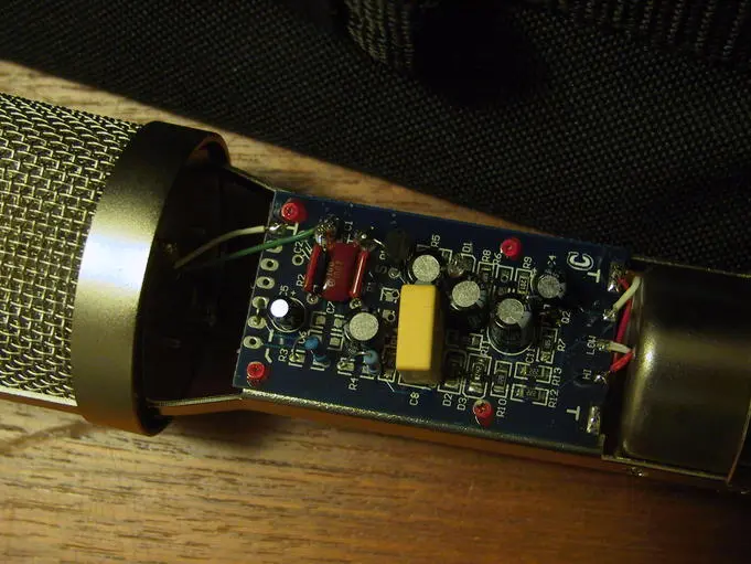

Shoot a nice high-res picture of the board(s) inside it. I doubt anybody on here has disassembled one yet, as they aren't nearly as common as the MXL, CAD, Studio Projects, or Nady mics. Without a picture, I'd just be stumbling around in the dark trying to give any suggestions. :)
I've got one -- I opened it, and it looked like pretty high quality components. It also doesn't sound so bad (IMO) :D What don't you like about it?
But please do post pics - I'm in the middle of moving and mine's packed away.
That mic is a prime candidate for the "Royer mod". I've done quite a few with that body.
M-Audio Nova Pics

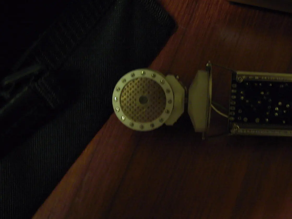

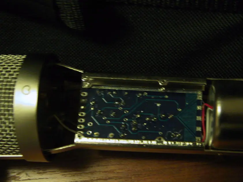

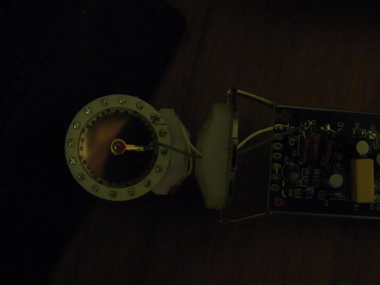

Sorry for the wait, 3 digital cameras and no charger :p Still, now all works, so any more pics you need let me know. There is just the one board, one sided.
As for the Royer mod, is that the tube mod? I would prefer not having anything needing a power supply. Still, it looks like a nice idea, but I'll have to see if there is anything else I can do first on the solid state side of things.

Looks like it might be ALMOST an older u87 type circuit set to cardioid.
Does it have a harsh high end?
Leave the basket alone. The transformer might be fine as it is.
Study the old Neumman u87 schematic for ideas.
The one cap that will make a difference is the one between the two 1gigs try different types.
Question what you read on the web.
SMD can be OK.
Compare the circuit to a u87 I would guess the u87 schematic will be a good help tracing this circuit.
I've got some polystyrene xicon caps, 50v .001uf laying around, does that sound at all like it would fit for replacing that one cap?
The stock mic does have a fair bit of high end, which I find rather nice on acoustic guitar but a bit much on pretty much anything else. It also gets rather harsh, almost clippy, in louder sound sources. Short of adding a pad, what can be done with that? I would love a smoother sound for vocals.
SMD? Is that the surface mounted components?
Tearing out a few layers of the grill seems like the easiest mod, why do you say not to do that? Would that bring in too much high end?
Being a beginner at schematics, I really need the most help in interpreting what the U87 schematic would mean to this circuit.
How much of a difference would a capsule change make? If this is an 87-style mic, would something like a peluso cek89 suit it?
