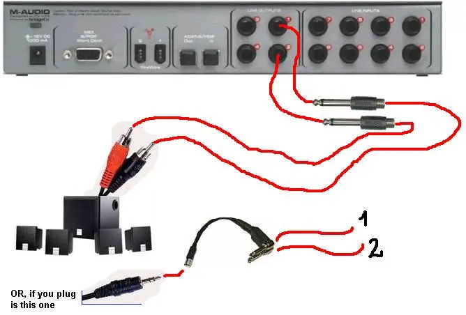

i tried using the same splitter thing i did, and plugging it in the output jack, but the sub didnt work and the sound was mono.
attachment.php
You won't have rear channels with this. You have to mix the two 1/8 jacks to 1 single jack.

ahhhh
now i get it.
that diagram was great.

Nice!
Not the pretties diagram ever, but it got the point across...
