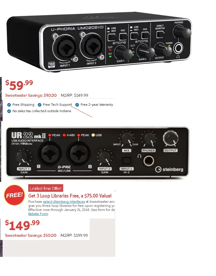

I found that I can now buy a Behringer U-Phoria UMC202HD for only $60, or a Steinberg UR-22 for $150.
The Steinberg UR-22 comes with Cubase AI6, while the Behringer UMC202HD comes with Traktion (now a free) DAW. Some reviews I have read say that they would choose the Steinberg if only for the fact that it comes with Cubase. I have never played with Cubase - only Reaper and Audacity (I don't really consider Audacity a DAW though), and for a few days I played with Magix Music Maker, and for a far more brief period I gave FL a spin. FL was too confusing for me, and far more than I want. I did install Traktion, but could not get it to work on my computer. I don't know why that was.
One nice thing is that if I were to purchase the Steinberg UR-22 with Cubase included, I would save the $60 I were going to spend to purchase Reaper.
Anyway, I'm asking you about hardware and here I am talking about the software. That said, I also read that Steinberg's drivers are more reliable than Behringer's.

Low current , low voltage, low heat devices have pretty good life spans.
Maybe the weakest link/ concern will be the room or mic and not the interface these days? Software-DAW performance? More Memory? Chipset and drivers?
I looked at the two I'd go Behringer if you dont need the MIDI I/O.
Its more than 50% off and has nearly the same functions.

Well, it is very difficult to pass on the Behringer U-Phoria UMC202HD for $60. I don't need MIDI, nor do I ever expect to. As far as USB power, I think my mobo has enough capacity. I will be using headphones mostly, and maybe connect my stereo receiver line-inputs to the line-out on the AI. I don't plan to make use of 48V phantom power.
In the end, all I really want is a better sound than the on-board Realtek can deliver. And the ability to connect/disconnect cables without having to be an acrobat.
