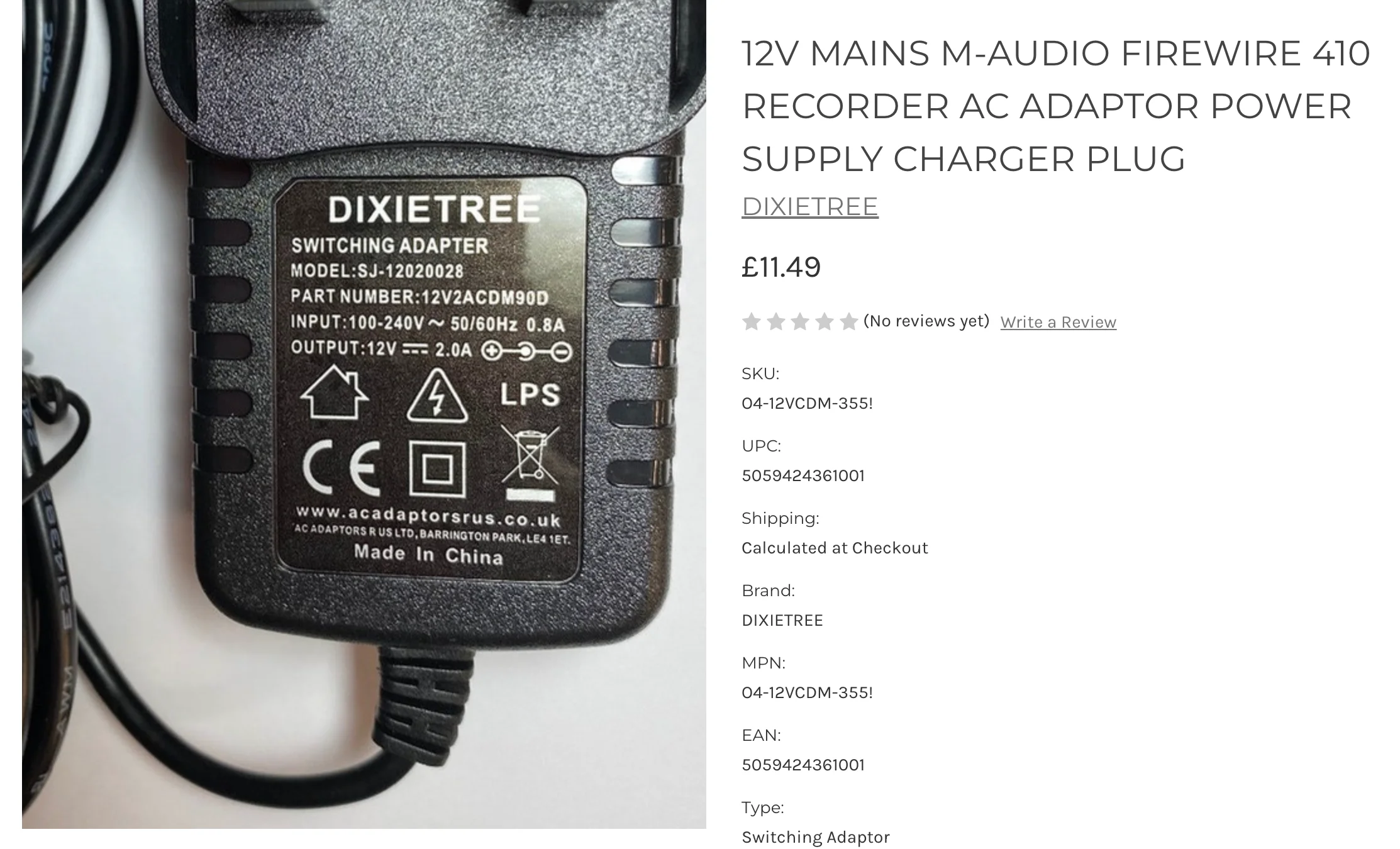

The tip is both according to Google It's a 9V AC psu or it's a 12V DC with + on the centre pin. Some people are going to be very unhappy.
HOWEVER, the Manual says it is 12V DC - so a bit more found a photo and it's a branded one with + on centre!

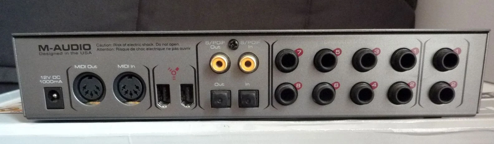

I guess it would be best to look at the back of the unit in play. MAudio has two different versions from what I see.
This one says 9V AC 1000mA.
This one says 12V DC 1000mA. From what I find, the center pin is positive.
