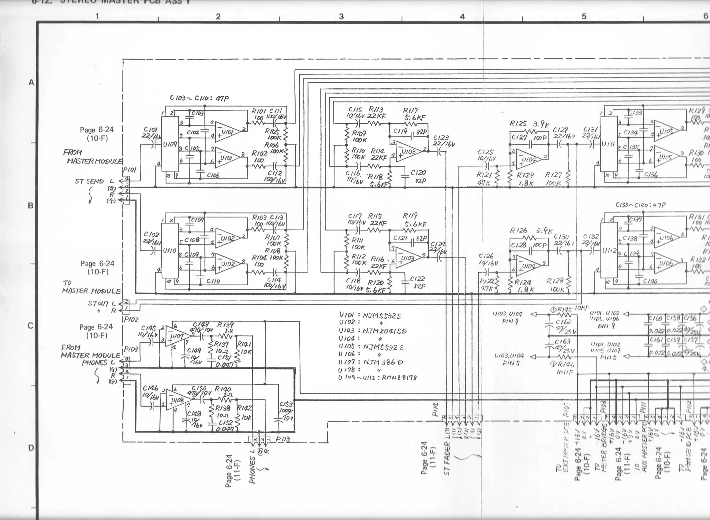

I do have the owners manual with the Schematics.
