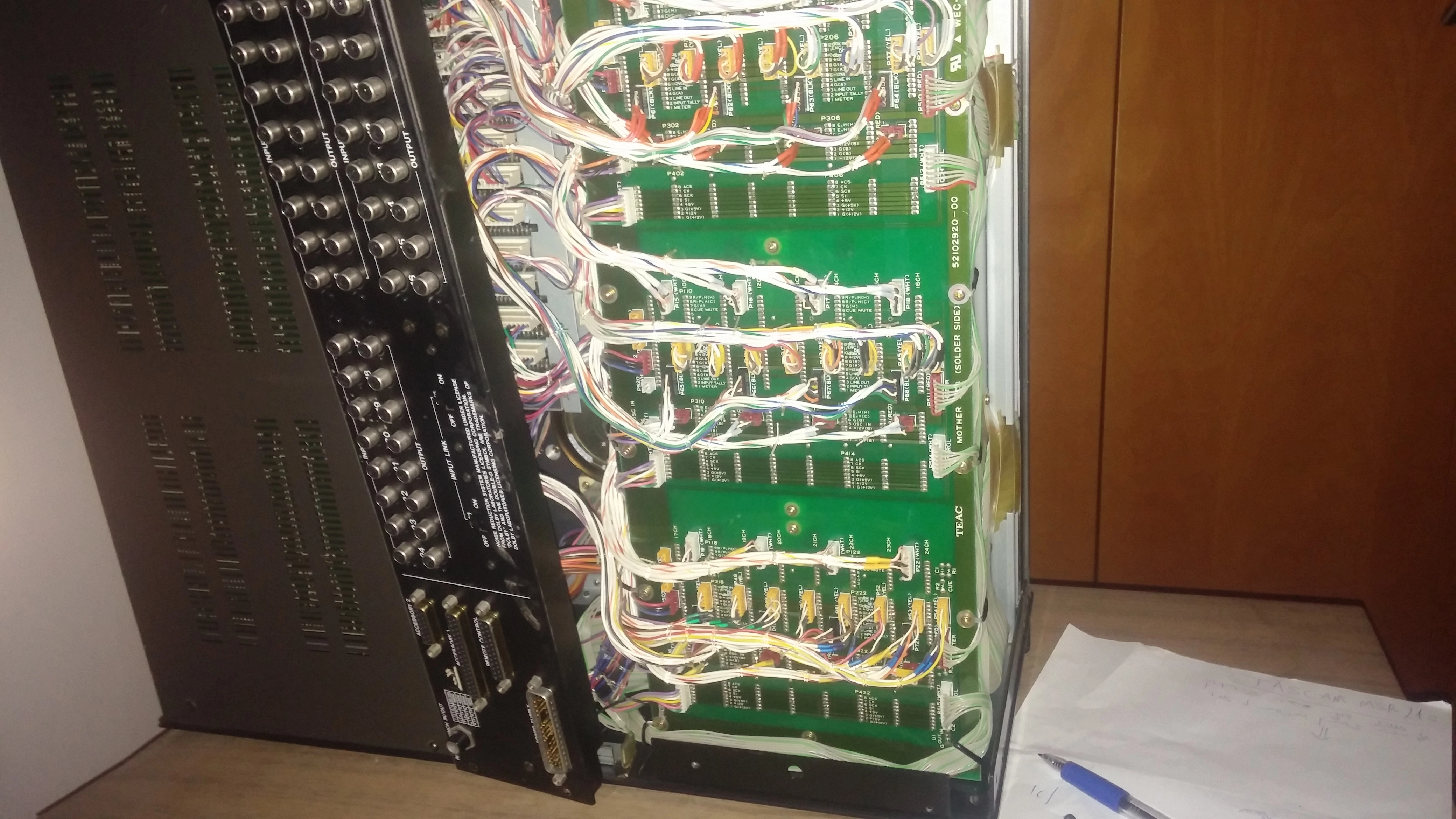

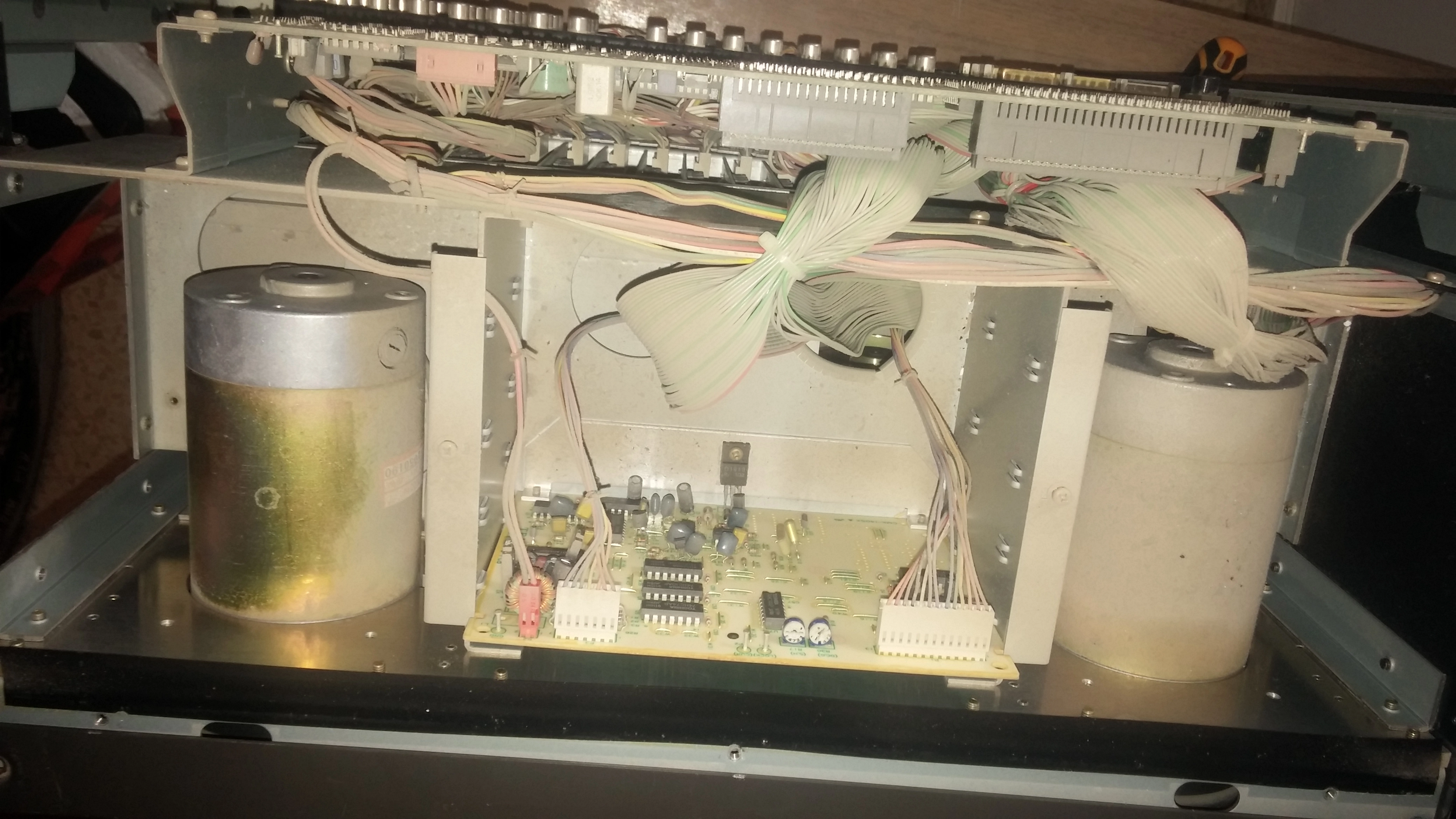

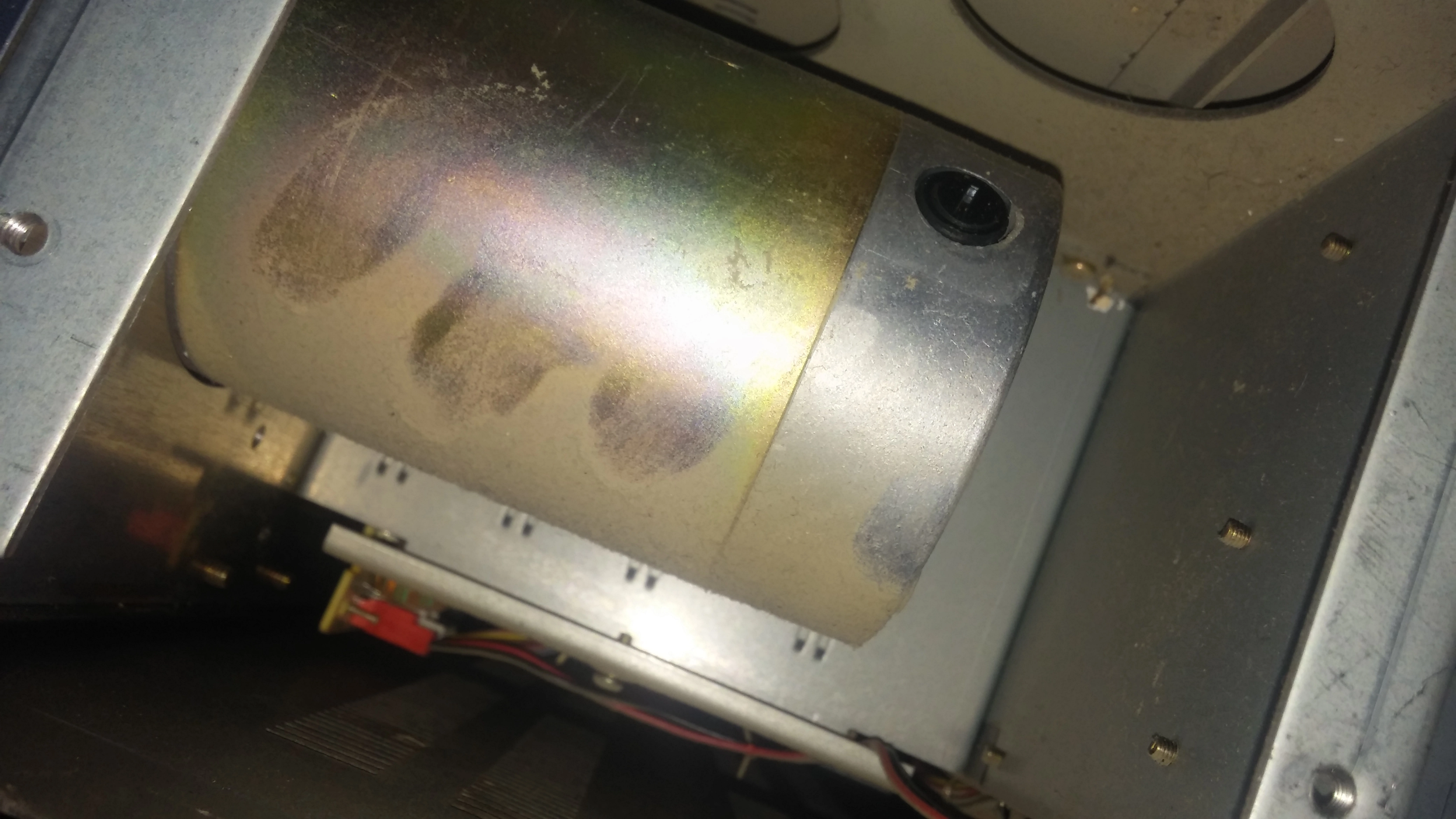

diving into the tape itself..photos attached.
the units inside are actually well isolated so it appears that most of the dirt got stuck in the upper side.
meanwhile, it's seems like a tough mission to put my hands on the manuals. i've contacted both Teac US and Teac UK and no response. i will try with the local tascam dealer next week..who knows he might have somthing for me.
trying to get to these notorious dolby cards. anyone can point me out the easiest way to get to it? and what shall i look for? just bad capacitors and leaks, or can be an "invisible failure"?
i'll keep update how it goes, for anyone that will come across this machine in the future :)

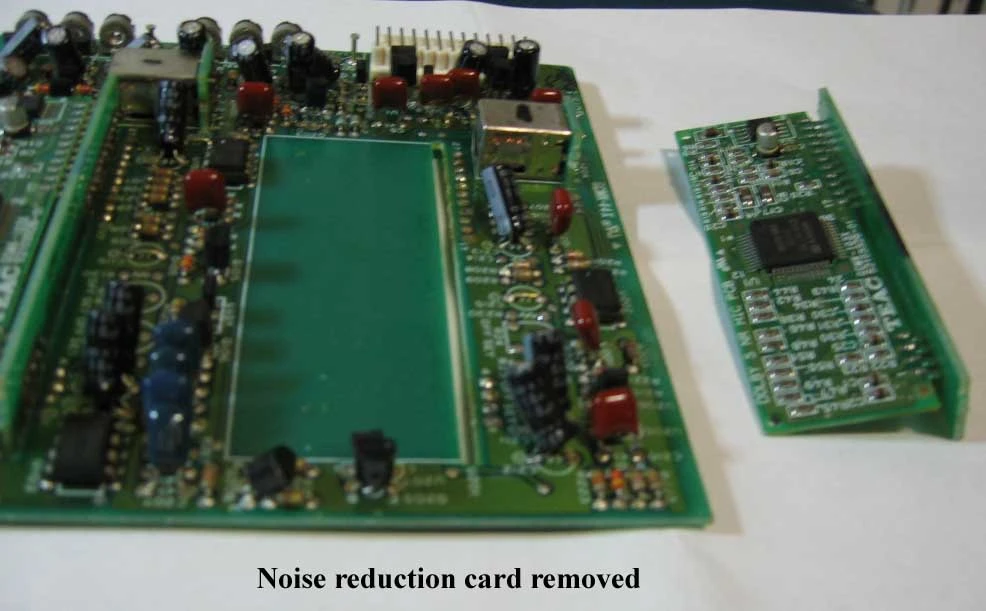

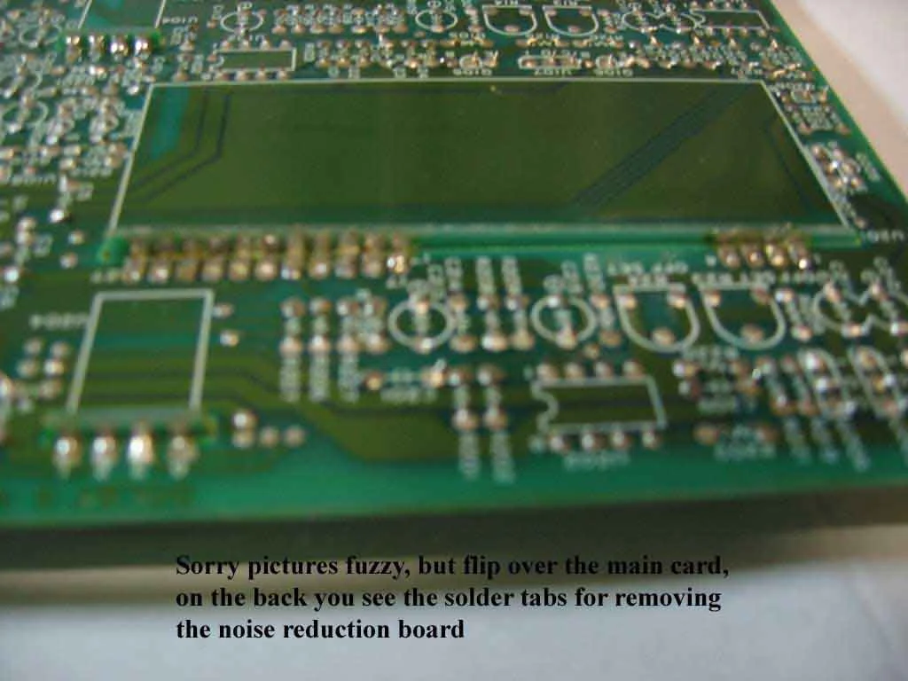

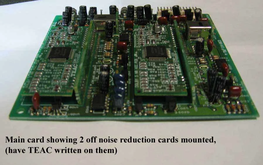

The dolby cards are behind the RCA panel. You take the screws out of the metal plate angle that runs across the top of the cards. You then with all the cables disconnected pull the cards out of the back of the machine. Oh the DBX version cards come out the same way.

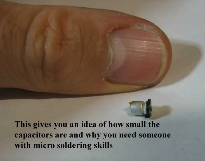

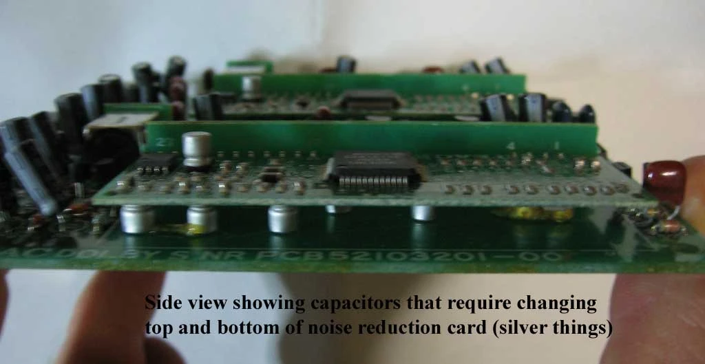

The problem with the dolby cards is the miniature surface mount caps on the actual dolby boards go out of spec. When this happens the affected channel distorts but only when the dolby is engaged. If this is not what is happening it's not the cards. Also there was a different version card with different caps that does not seem to have the same problems (earlier or later?) I found this type when I bought a spare parts machine.
I have attached photos of the work I did on my cards, you need someone with micro soldering skills to pull the cap change off.
Alan.

so yes, Im gonna assemble it back after cleaning and give it a try. if i spot distortion when engaging dolby, its off to the tech then :rolleyes: i am miles away of being skilled enough to do this kind of work.
