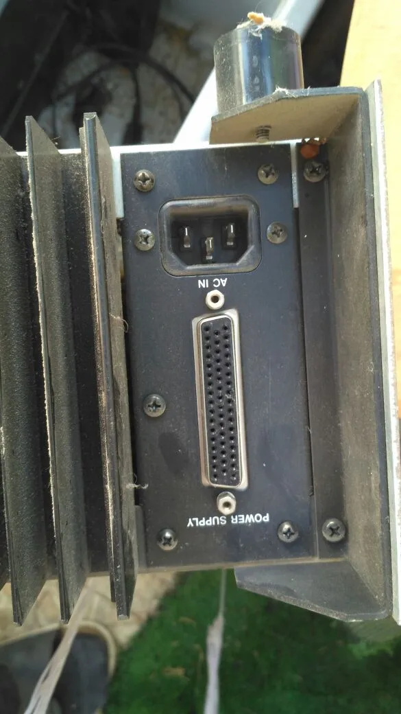

cable jack photo is attached. also i was able to find a photo of the cable itself: http://i.ebayimg.com/images/g/MmwAAOSw-vlVkW2K/s-l1600.jpg
so what about the actual cable? would that be possible to get a universal one, or maybe ask an electrician to built one. is it as complex as the power supply unit it self?

You will not find a "universal" cable for that application. You will need to get a copy of the service manual in order to get a schematic for the cable. It may not be straight pin-to-pin connection...and hopefully the service manual will include some specification for the cable itself...how many conductors, shielded or unshielded, the wire gauge (size). You'll need all of this info including the connector type if you're going to have somebody build it. It's unfortunate somebody was careless and lost the cable...never a good sign.
It looks like the connector is a 50-pin DSUB connector which is helpful as that is readily available.
Something like this may work: 50-Pin (DB50) Deluxe D-Sub Cable - Copper Shielded - Male / Female
But, again, you have to verify if all the conductors are "straight" (pin-to-pin), or if there are some that cross-over, and there may possibly be other components in the cable...diodes, resistors, etc. and the cable specifications need to be known and met as well.

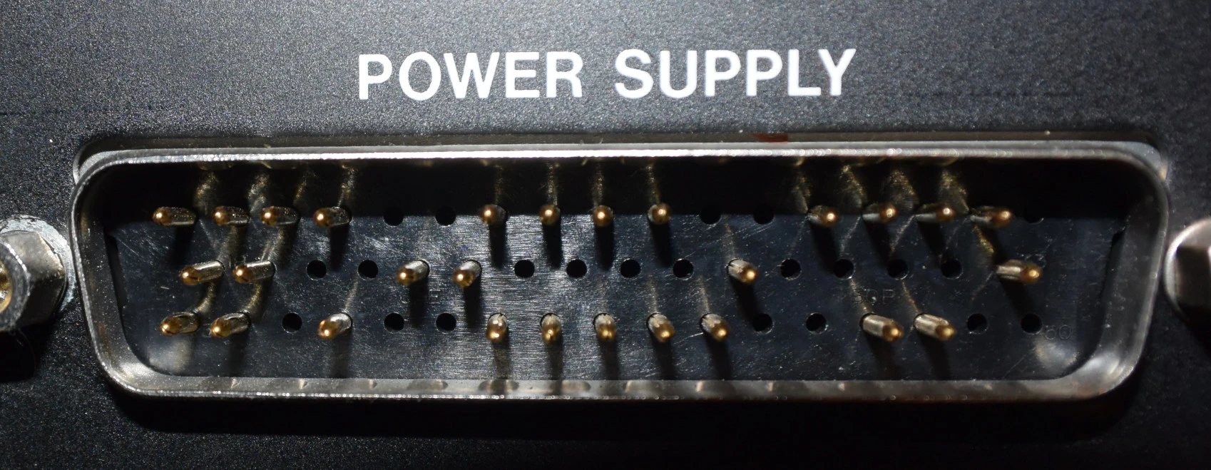

Regarding the physical allocation of the pins, the back of the deck itself looks like this:
EDIT: The numbers at the end of each row being 17, 33 and 50.

so from what i see the jack on the tape itself is more complex..a combination of pins and pins holes. any idea about that? what about taking that 50 pins cable and try to figure my way ? maybe dismantle one side and rengineer it?

Regarding the pins/holes on the power sockets, you don't need to worry about that...nothing special needed with the connectors on your cable. The pins are the ones that are actually used, what looks like holes are just vacant pin sites because they aren't used...Teac didn't populate what they didn't need to populate in the power socket housing which is typical, depending on the connector type.
