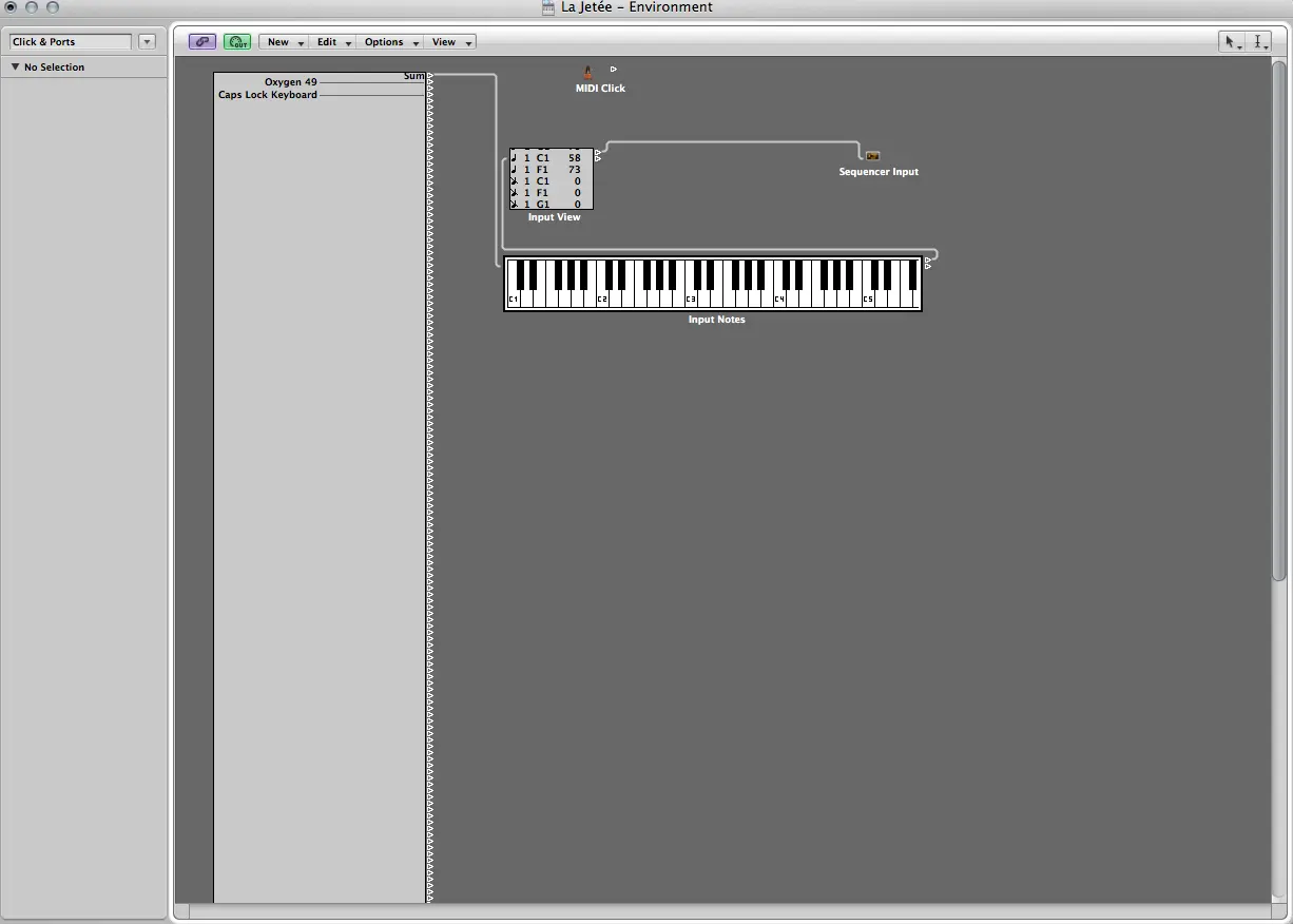

Everything looks fine (as far as I can tell) in the clicks and ports Environment Window but I’ll attach a screenshot if anyone wants to have a look…
