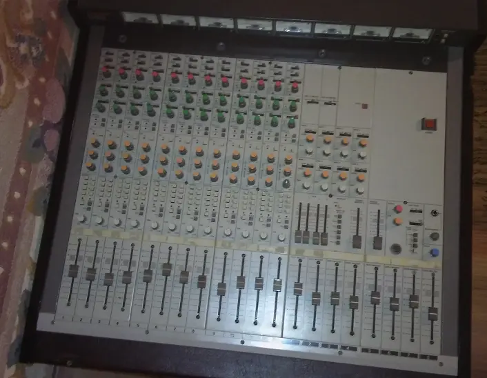

I run a little homy studio, pretty much satisfied with the gear i use (tascam 238, akai mg614 as the heart of it) but i do feel like getting an old Tascam mixing console. and oh boy does this old consoles looks awesome
(photo's off google)
Theres a wee little studio around my town selling one of this for 250$. they just really don't use it, and the owner wants to get rid of it pretty badly, but i doubt he'd go lower than that.
he reckons it was fully functional and sounded great last time he used it (a year ago or so), and of course i'll test it before buying, but i do take in mind the job i'd have to do if a total recap is nessecery. and that's my question exactly - is it?:confused:

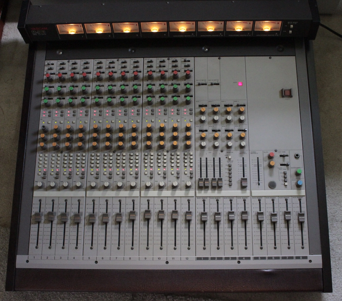

Well, it ended up taking some time untill me and the seller found out a good timing for inspecting this console, but there she is(!!:D) :
I was a bit skeptic about the purchase, but at the first look i was pretty sure it's going back home with me. it's just a really fine example of a well-maintained console. no parts missing, all lights work, all the inserts jumpers are present. All the main features we've went thru worked flawlessly. the knobs and faders are super smooth, the kind i woul'd expect from a recently serviced console.
it did spent the last year at his storeroom, therefor i've declared a cleaning-day ahead!
channels sounded fine to us. i woul'd take the time to get familier with this console before i dive into recap.
i didn't even bargained with him, as 250$ felt super fair for me.
gonna hook it up with the Tascam 238 to make a fierce 8-track setup..!

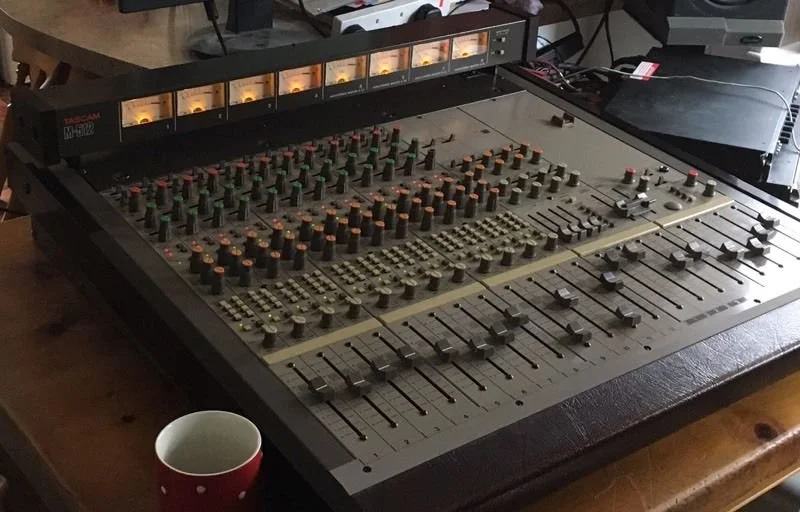

I love my Tascam M3500 32 channel and 16 track 1” Tascam MS-16. They’ve both been easy to work on, and sound larger than life without DBX.
