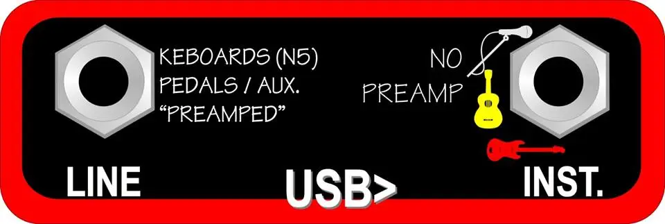

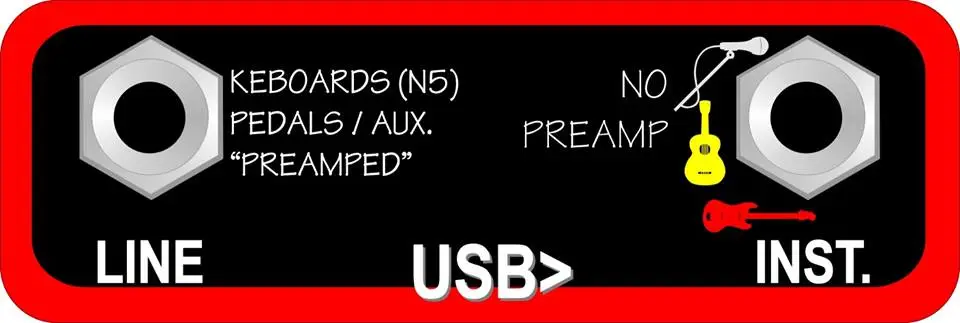

I'm a little LATE with this post but for those that follow...
I TOO use a Focusrite 2i2 and the LINE/INST switch as I've found it to act,
does both of the things mentioned above;
1. The volume level and tonal qualities change when you flip that switch.
You can tell because if you're using ANY KIND of pre-amplification in the
Instrument position you're gonna have a tough time getting a green light
(input level) without going yellow and RED... (clipping) It's almost impossible.
I got really "twangy" sound out of guitar tracks I recorded using a BOSS
ME 30 pedal (considerably a "pre-amp" on the instrument position. BAD...
2. The Impedance. Without the Electronic tech lesson, this is basically an
INPUT GAIN issue; Plug a guitar directly into the 2i2 on "Instrument" and
your 2i2 becomes the preamp, boosting the tiny voltage (relatively) that
is created by the pickup ALONE to the level that a good recording is possible.
I use this with plugin AMP simulators in Live9, and it's fantastic, and lots
of gain adjustment without effecting tonal quality or clipping.
NOW you have to think; What's a preamp? What instruments have them?
While it may not be an actual preamp, ANY PEDAL usually boosts input,
and so impedance matching requires the "LINE" setting. Mic preamps?
the same, while without using a mic preamp I would use the Instrument
setting.
My Korg N5? Pre-amped >LINE
Anything with a "line out" requires "LINE" ... it's already been processed and boosted.
I have a seven string guitar with a "crunchLab" aftermarket pickup, and it produces
so much output voltage I even use LINE with THAT straight, just because I can add
gain without effecting the massively wider tonal spectrum, but that is an exception.
Here's a graphic I made up (IF I can post graphics, we'll see) that might help. Save it!
