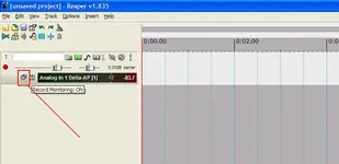

Ok I'm gonna try out Reaper. How do you monitor yourself in this program?
Like this:
