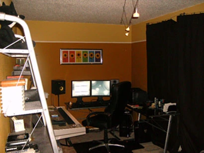

Sorry for the small images... i took the pics at a high resolution so when i made them smaller it really changed the size. Here's a bigger photo. I also removed the front fan on my pc and that did make a big noise difference. I don't like the idea of water and electronics so i don't think i want to do the water cooled pc. I found an article online with lots of sound proofing ideas and i think i'm going to try a few of those things. THanks alot guys!!

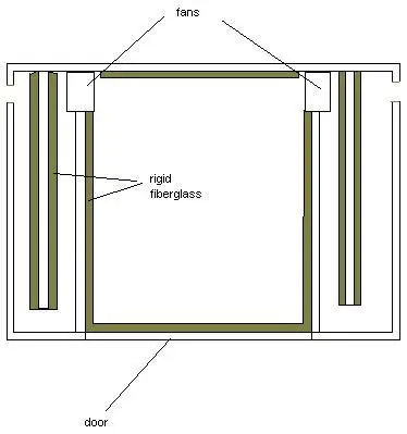

Best way to sound isolate your pc is to put it in a sealed box. Something with mass, like MDF or something. Obviously you will neeed to install fans to keep it cool. But this will create a problem, 'cause the sound will just leak out the gaps.This is something like a design posted about a year ago, i think by fitz.

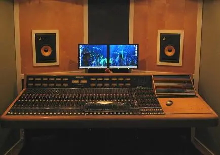

We Made Some Changes and this is the way the studio looks now looks now (Part of it).
Absolutely gorgeous!
We have a winner! I'm seriously jealous!
Great stuff! :)
