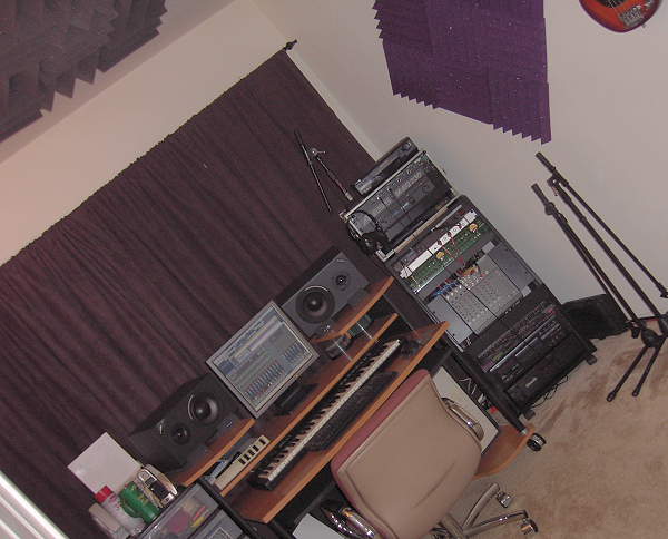

nice!
Not only am I jealous, but we have the same desk!!! And your monitors on the shelves instead of stands just like I will have.
Do they work well that way with little refelctions?

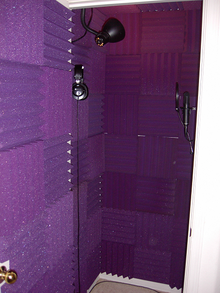

thanks! yeah for $150 you can't beat that desk for a DAW. Actually, I am planning to upgrade my monitor system as I find the M1's a little boomy. The curtain on the back wall I just hung up a couple of weeks ago seems to help tremendously along with the Auralex MoPads. I was looking into getting a new desk but I like this one because the height of the shelves puts the monitors DIRECTLY at my ear level............the wedges on the walls and ceiling cut down the HF reflections a bit and keep the neighbors happy. Right now I am doing mostly voiceover work because I am in an apartment... :mad:

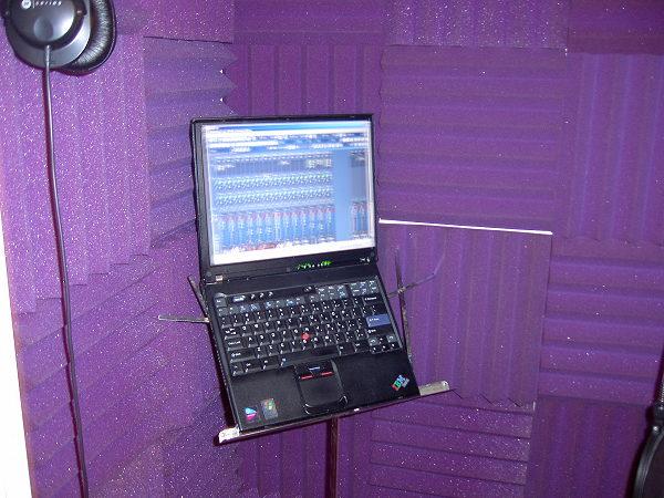

another thing I just started doing that is a huge timesaver ... controlling the daw through a VNC server and a wireless network ..........
it's a little cramped but it's nice not having to constantly run back to the computer to access the transport

Please explain how I could control the software from the live room!!!!!! When I'm recording drums alone it's a bitch having to run between the CR and LR.

assuming you have a home network, you can download realVNC here:
http://www.realvnc.com/
the program is free and basically you can set up your DAW as the server and the "controller" computer as a client. It's easy to setup, everything is explained on the site or in the help file..........
or...if you are running XP pro on both systems, you can just use the Windows remote desktop app
Another option would be to customize the key binds in the software and get X feet of USB or PS2 extention cable and just move your keyboard into the live room when you go to record something. That's what I've been doing when I'm not in my crappy spare bedroom heh.

Is that small thing stable enough to hold that laptop?

actually it is...but I only keep it in there when I track my own vocals which it is not that often. Otherwise, I use it as a second monitor for plugin windows in Sonar.
