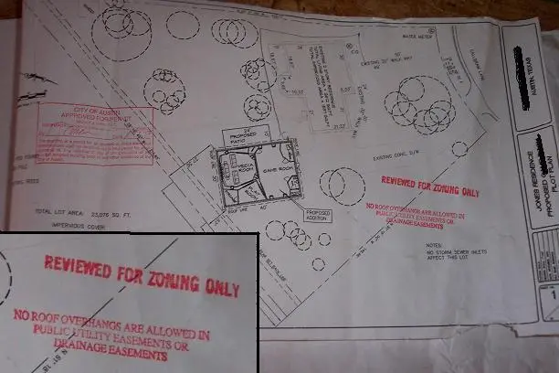

I'm actually pretty proud of the fact that I haven't circumvented any code or regulation in my project.
And it is compliant with zoning regulations at the time of permit issuance.
(The City of Austin doesn't actually "approve" anything; they simply review for code compliance)
The cover sheet from my permit set.

Also, I'm curious about those plans (the photo you posted). It mentions a Media Room, Game Room & Play Room. No mention of tracking rooms, ISO booths, or control room. Was this by-design? (To help get the plans thru?)
