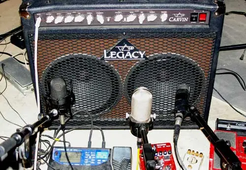

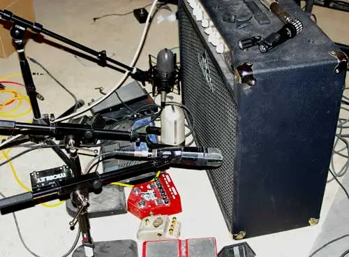

A couple pics. Man, that flash really shows the dust! And ignore the stompboxes--they're just getting in the way. None of them are in this recording.

Ahh, nice - the RSM-4 is my poison of choice on guitar cabs.
I've never tried more than two mics at a time - I'll have to try that sometime, but at a bare minimum I'll be experimenting with adding a SM57 or i5 in to support the RSM-4 a bit in the high end.
I've had the same experience, BTW, with ribbons - especially if you're pushing any serious volume, even with a pop filter to take the edge off the air movement you really don't want it super close to the cab because the low end just gets out of hand. Pulling it back a bit, 2" or further, seems to help control the lows while keeping the high end a little more airy.
BOSS ME-30!!!!! What a pedal! :D
Yeah, I was actually it with a Digitech delay pedal--the ME 30 has a decent delay, and I was seeing which I liked. Meh, they're about the same. I don't record with either of 'em. Just like a little delay on the leads when I'm jamming.
