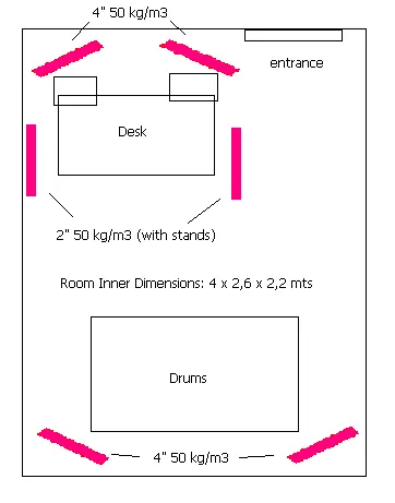

I´m getting closer to finish my first studio...
Check the layout, what do you think?
Clouds are gonna be the next addition...
The 2" panels (both with stands) are meant to be used on first reflections points -during mixing- and on any other place during recording...
Comments?
I would strongly recommend flipping the room 180 degrees. You really want your mix position set up symmetrically in the room - not offset like that.
Bryan
I tought about it Bryan, and maybe i´ll do the switch later (long story why i don´t make the switch right now)... but, anyway, i think that the plan still remains the same (about were to put insulation, the density and depth of panels)...
Am i right? :confused:
Thanks!
-The only thing to move should be the first reflection absorbers... and that´s one of the reason why i wanna make them with stand-
Well, you should have panels behind and between the monitors too. The angled 4" absorber on the right side of your current setup is doing nothing for bass control. It would need to be over by the door (and I'd do that too in either case even though you can't straddle much.
Bryan

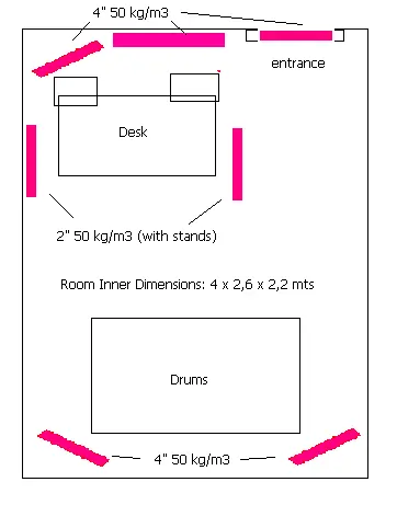

Thanks Bryan! Something like that?
Take the one on the door and move it over to the right wall. Do just a very shallow straddle on the right wall/front wall corner to be able to fit in behind the door.
Bryan
