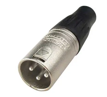

I'm not calling you stupid here, but just to clarify....
The connector going into the interface looks like this right?
lol yea. XLR

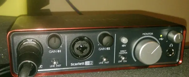

Returned the other one and got a new one. But it is still dong the same. So I am thinking it is something on my end.

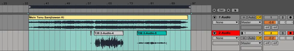

Without Cloudlifter/phantom power: I have the gain at 9'o clock position, and the input signal is barely audible. I can see the light of the gain knob flickering green. But the waveform in the DAW is very small and I have too raise it 10-15 db to hear it. The output comes through fine. It is the mic input that is the problem.
I have posted the pic of the waveform with focusrite and my previous interface:
1. I reinstalled the scarlett driver
2. Changed the mic cable.
3. uninstalled all the other sound cards
4. Reinstalled ASIO
5. plugged it into the second line.
But no change.
