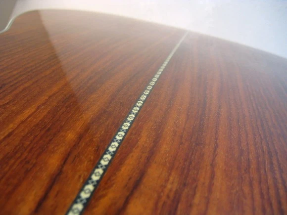

hey, can anyone tell me offhand if my guitar is made of real or fake wood? it's a '82 (or '81) Yamaha FG-345II acoustic. i really am dumb and don't know how to tell if its laminated or actually made of good stuff. :confused:
it sounds pretty good to my ears though, i just want to know out of curiosity.
here's a pic of the front:
and here's what the back (and sides) look like:
You can often see if the top is laminated by looking at the edge in the soundhole.

It's probably real wood, now what that means is a different story. All that matters is that it sounds good and you like playing it. You can get two of the same year guitar and have one be amazing and you love it and the other one was made at about 4:57 on a Friday and is a total dog. Boingoman's right, the soundhole says a lot.
If you're uber curious, grab your serial number and call Yamaha and they'll tell you about it (hopefully). I've bothered Gibson/Epiphone about 5 times about whatever I've picked up from music stores.
