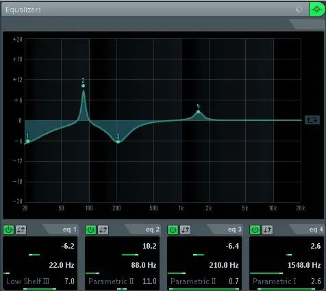

Btw, here is a basic eq setting for kick drum I generally use as a starting point:
why don't you roll off more bass, like a HP in around 40ish??
and i feel like the EQ's in pro tools is only 7 bands. would i actually have to buy one that has more or would anyone have a good one for free?
I was learning at belmont about how if you boost the 80Hz and you have a great tone there, that there will be another at 160. and another at 320 same goes for awful sounds.
I'd like to actually try it but it's hard with 7 bands and 2 of those are HP and LP which eats more away. :[
I like the air down there. The octave thing can work but I wouldn't go boosting all of them. I rarely have a need for more than 4 bands of eq. Good recorded tone does not need much eq. IMO, 7 bands is already overkill. Eq can kill tone quickly. Especially stock ones.
You "feel like" it's 7 bands?
Anyway, I rarely need more than two or three bands of eq on the kick to get good sound. Maybe this Belmont place should have showed you how to tune and mic a kick properly so you don't have to hack the eq to death. If you really need more than 7 bands you could chain a second instance of eq after the first.
