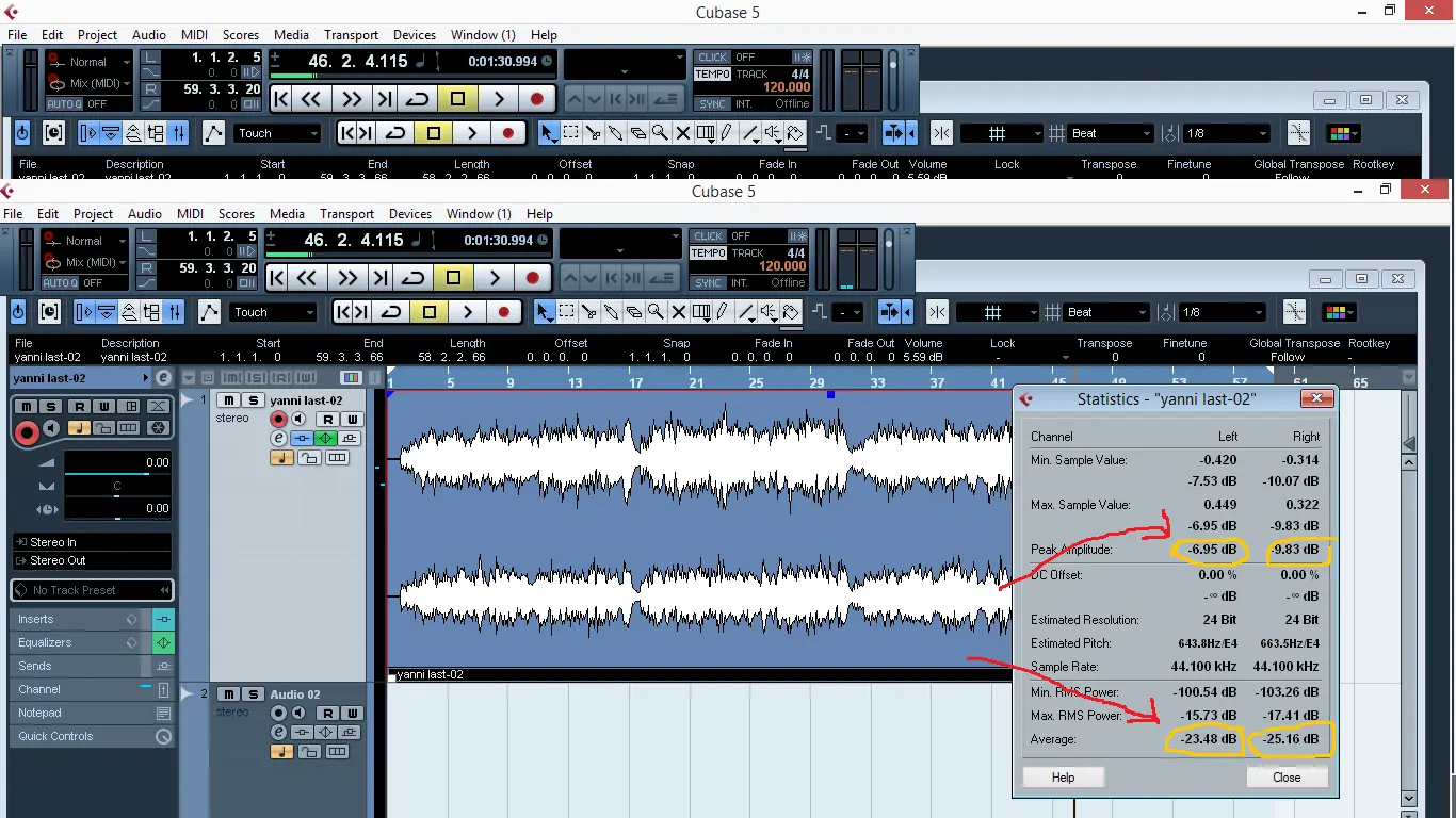

hi all,
i wanna record a piano song with my keyboard,
but my problem is in stereo recording usually left signal and right signal are not equal,
sometimes left signal is stronger and sometimes right,
when my record has finished i want do compression and EQ and prepare my track for mixing and mastering but left and right has different Peak and RMS average so what should i do in this case ???
as you can see in picture peak and RMS average numbers are different and left signal has a higher peak,,,,,
I guess I'd be surprised if they were measurably always the same! The question is, how does it sound? If you're happy with the mix don't worry, and if it's unbalanced, you can fix that in numerous ways, like EQ and compression. But this is also something that can be addressed in the mastering step if you think the mix is good.
Posting an actual clip might help because there's at least one contributor here who does a lot of keyboard stuff.
This is one for using the ears before the eyes, in my opinion.
A mastering engineer's take would be interesting, where a solo piano piece is concerned, but certainly in a mix I leave this alone.
The common reason that the left side is 'louder' is because it has more low frequency content due to the microphone placement, or digital approximation if it's a digital keyboard.
For all things to sound equal low frequencies require more power so what looks louder may actually be well balanced.
As Keith asked, how does it sound?

Sound is perfect and Balanced,

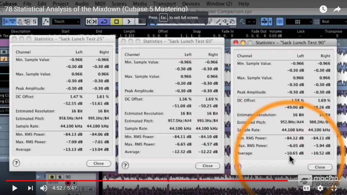

but problem is after compression and maximizing, RMS average and peak on left and right signal still show different numbers,
and i imported some market songs in cubase i have noticed all songs RMS average and Peak number on left and right signal were same,
its confusing meeee,
I think this is a problem of too much information. As Steen stated, listen in the mix, while these visual graphs are good to hunt a problem, they shouldn't be used to create a problem you don't have.
Listen, if you don't like, then use tools to sort it out, if you do... next.
The only way to reduce the differences in the two channels that I can think of is to feed them into an "MS" encoder then reduce the level of the difference signal. Upon decoding it should be 'less stereo'!

Ignore the numbers.

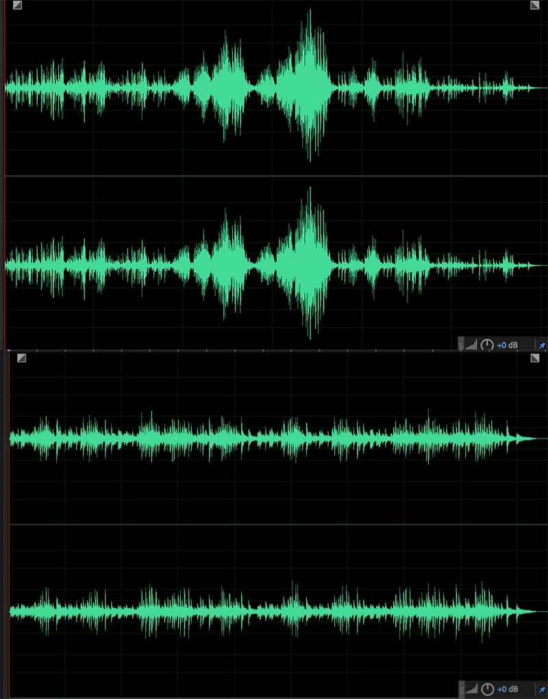

I record loads of piano - as it's a major part of my income stream. This is real piano AND VSTi piano, and left and right tracks are NEVER equal. If it winds you up, and you want to fix it, even if this makes the thing sound wrong, then simply raise one of the channels, but I've never er done this in my life, because real pianos have huge amounts of energy in the left hand, and those dinky short strings higher up lack real power. That's how pianos work. I'm also really surprised you are compressing and maximising a piano? I assume it's some heavily effected poppy track that is meant to be LOUD?
If it really winds you up, who not just change the levels on record to favour the lower channel if you have to have the meters the same? Frankly, the only question should be "what does it sound like?" If it sounds good, and not offset to one side in the monitors then it's fine.
It's never even occurred to me to analyse a recording like you have. What's the point? All my stuff is classical, jazz or show tunes based - and quiet songs are low, loud pieces are loud - nothing is normalised. Pop and rock piano is different of course - but then then, piano is rarely lacking dynamics, while electric piano sounds is often lower in dynamic range.
