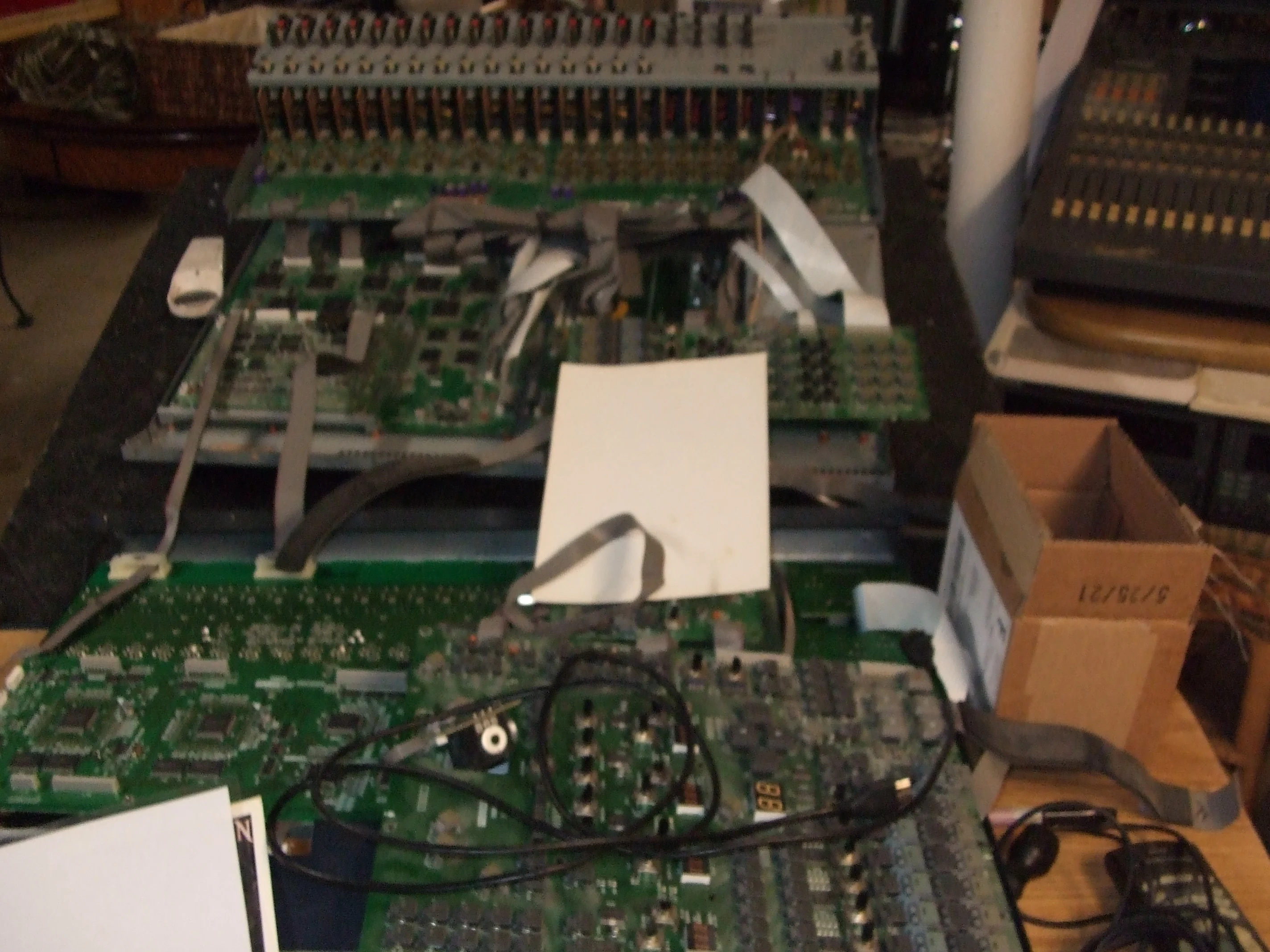

I have opened. My Ensoniq is a nightmare. You have to go in through the bottom and put her back together that way and you are always fighting gravity. If they were still in business I would call and ask what were the engineers thinking? Maybe they let the electrical engineers do that part instead of a mechanical engineer? Not a keyboard but I bought a Yamaha 02R96 mixing console with meter bridge for 250.00. I think it might have been dropped, right bottom rear corner was dented, had some broken pots and bad switches. I opened her up and pulled all the boards and took me a year to get all the parts but she is back together and up and running. That was fun.

NOW, I have to open the 02R96 again. It seems the batteries I bought off ebay were at the end of their life. No more batteries from ebay. I don't know

The 02R has a firmware problem and is just sitting there and won't boot. I can't seem to find any help with it.
