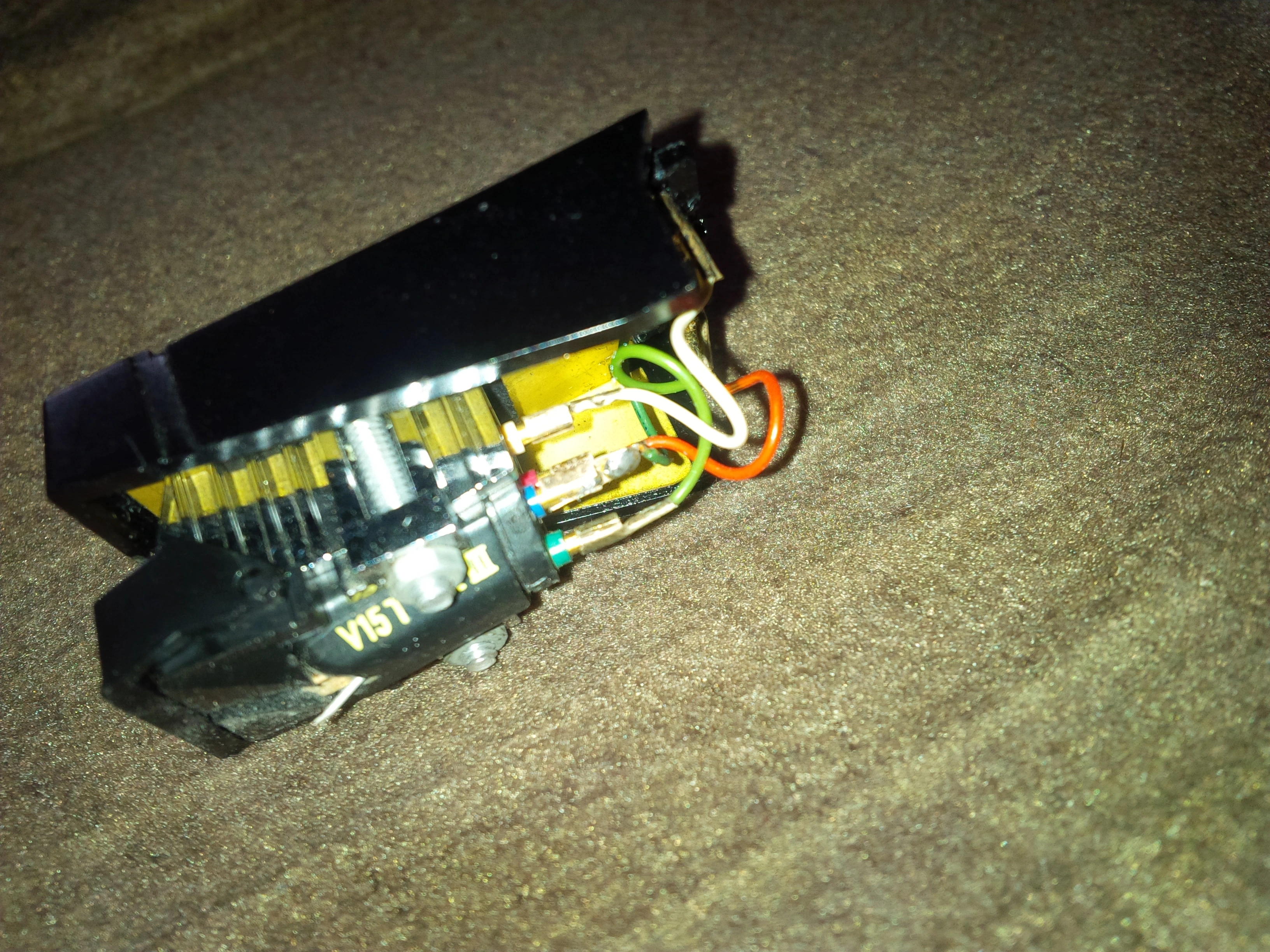

Well this sucks...I finally get around to mounting a new cartridge and the mounting screws from the old cartridge are too short for the new cartridge. :cursing:
Can anybody help me figure out what screws I need and where to get them? I'm so not a turntable guy...
The cartridge I bought is a Shure V15 Type II.
You'll need non magnetic ones. Im sure you could use ones that aren't, but non magnetic, aluminum, are usually used as they are close to the cartridge. I have a shure V15 type III which is pretty much the same as yours in appearance. I measured the length of the screw and I'm getting 19.70mm on my cheap digital verniers.
If you have any audio shops in your area that sell turntables, then they should have accessories like the screws and wires etc. Or you could source them online. Now mind you, the length of screws I have, work for my shure paired up with my headshell. It could be slightly different with yours. But Im pretty sure that length will work.
Thanks j.harv...that's the stuff I need to know. :cool:
