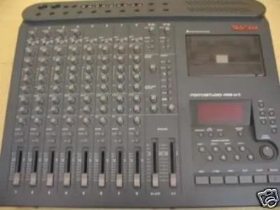

I've known of the technique for milking 8 individual outs from the 488mkII, as there's a good write up on it on this site. However, I've never had the need or opportunity to apply this info. (Got a 688 & 238 if the need ever arises).:eek:;)
I like the 488mkII a lot. I wanna rock!!!
