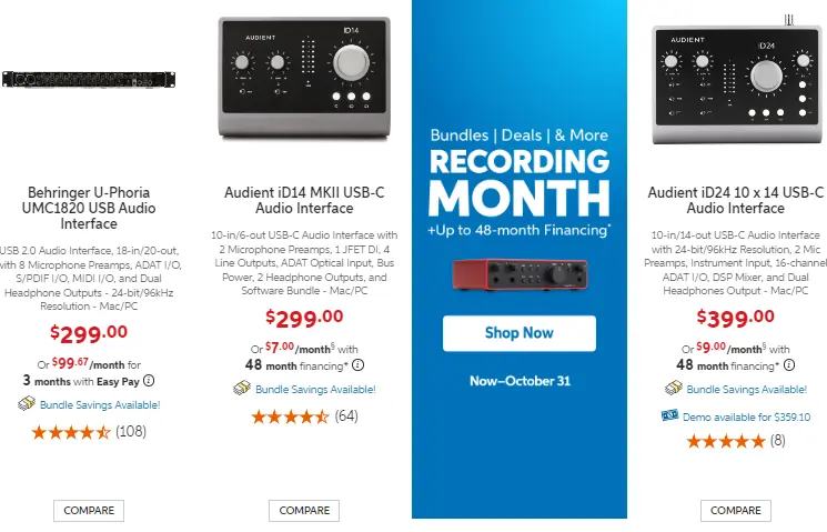

You will need an interface of some sort ( at least this is what I believe) that takes the 8 ADAT tracks in and delivers them to the PC digitally via usb. The two cheapest interfaces I saw at Sweetwater were the Behringer 1820 and the Audient iD24 ( the 14 only converts 6 ADAT tracks at a time)
