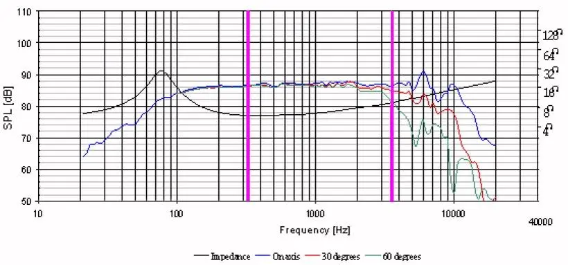

Whew, way more than I planned to go into, so let's take a break for a minute and try to absorb some of the above stuff. To illustrate the directional versus dispersion effect, here's a nice midrange speaker curve. Notice what happens to the high end response past about 3,000 Hz; it starts falling off as you move further off axis.
More in the next post.
