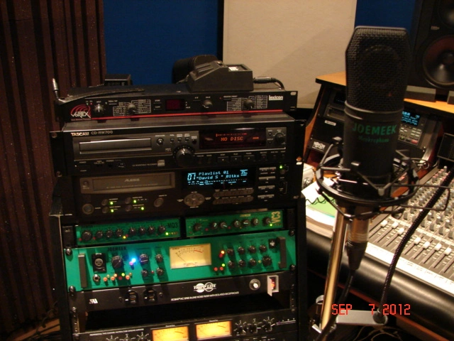

Shameless pic of my meek gear section grouped for a photo op. There is one more VC3 not shown. That's the recently-repaired one in transit from Torquay.
