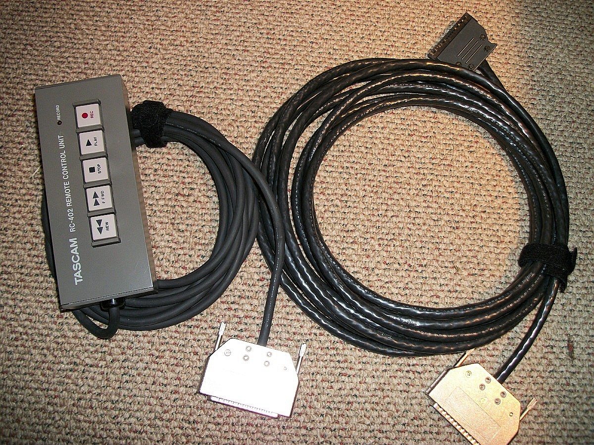

I found a couple for cabling I made up for my BR-20T at Mouser. I think the threads might be metric. Maybe you can take the original jack-screw to a hardware store that sells metric hardware and confirm the diameter and thread pitch and then you'd know what to ask for as far as the hood when you go shopping, but I know I got some nice all-metal DSUB-37 hoods at Mouser.

According to the catalog linked under Data Sheet in the page linked in my last post, the jack screws are 4-40 thread.
Thanks sweetbeats, I ordered one. but it's funny I've looked in the same catalog under D-sub connectors and never found that one. :confused:
Yah I was happy to find them. Got two...one to make an end for the cable between my BR-20T and Time Line Microlynx, and one to repair the end of the cable of my RC-402 remote which was missing the hood. They're really nice and heavy/chunky.
