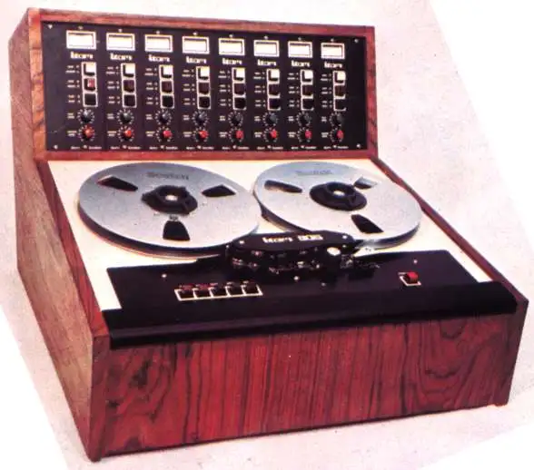

Got a picture of this beast?
Cheers! :)
this is the beat
It was made in 1973 in London. I think they were one of the first

Seven deadly sins or not, I want one of those in my living room. Check out the teak. That is the Austin Powers of tape decks. :D
it would be even better if it worked.
But yeah she is a sexy beast

Oh, wow. I've never seen the angled ones before. There was an 806 model which looked like a first-generation Otari 5050-8 (two separate units for the transport and the electronics).
This is a piece of history, and I'd kind of like to have one even if it didn't
work ;)
I've heard they're based on the Revox A77.
