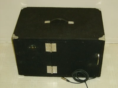

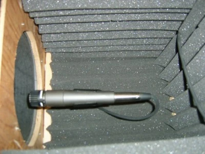

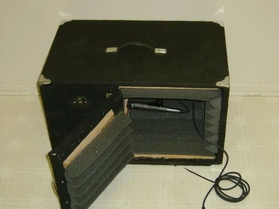

I threw this thing together last night. It's 15" x 16" x 25" and loaded with a 65 watt 8 ohm Carvin VL10. I have a buddy that needs to record under a more "live" setting. The guy in charge of the project wanted to take the line out of his amp straight into the board. Pft! that'll sound good! :rolleyes: So anyway, here's what I came up with to fix the problem. I have been trying different amps through this iso cab and a 30 watt class A tube amp dimed is just slightly louder than a normal TV. The tone takes some EQing to get it to sound right on tape but I think over all it should work out great for recording in certain situations.

This is uncanny. I've been toying on paper to build something simular. I want to put together an iso-box that'll fit around an average 4-12" cab (as that would be the worst case scenario) except with a window and a remote way to move the mic so you can see where it's pointing and make adjustments on the fly. Looks very cool sir.
Looks good....
How does it sound, both in the room and in the recording?
How does it compare to the sound of the real cab?
amra said:
Looks good....
I think it sounds decent on tape. It isn't anything like the normal close mic/distant mic technique I use but all on all It sounds great. I think absolutely cranking a tube amp is always a good way to get guitar tones.With a 30 watt Class A Tube amp dimed it's slightly louder than my TV.
