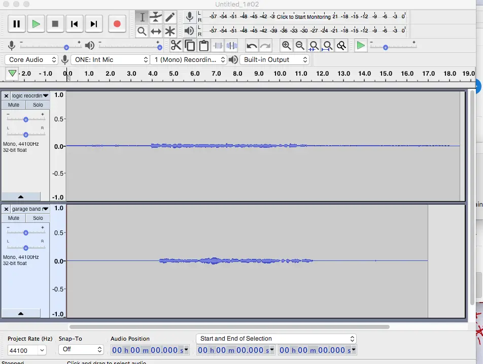

If you hear hissing in Logic, the question is where it's coming from. Do you just record and then play back with no effects and no changes in output monitor volume in the interface or DAW, and you hear these noises? What is the output level (dB) on the Stereo Out track in Logic? Can you put a (Utility FX menu) peak meter on the track and Stereo Out and tell us what those are?
However, it shouldn't be necessary to get a clean recording of a condenser mic through any interface in Logic. The hardware and driver are exactly the same, so the raw track should be the same. This is easy enough to check by simply recording a track in GB and then without changing anything, record the same thing in Logic. Open up the projects as a folder, and find the media file for your track. Then, open those up in something like Audacity and compare them visually and audibly.

I am testing recorded and played back with no effects. The sound is only noticeably different at loud volumes-- when I record louder instruments, it doesn't matter because the mic picks up enough of them that I don't have to turn the track up enough to hear the hiss. For quieter instruments and when I add compression the background hissing noise level becomes noticeably different in the logic vs garage band recorded tracks. I expect some increase in background noise with compression, of course, it is the difference in the volume of the hiss between recordings from the different software that I have noticed. I have also noticed that my recordings in garage band are louder despite having the same gain (even when I load them into the logic file, the garage band tracks are louder than the ones of the same thing I record in logic in the same way at the same db setting.) So this may be less about there being an extra hiss in logic and more about logic getting less signal from the acoustic instrument or voice while passing on the hiss of the mic. That makes sense to me in theory, but I don't see how that would be possible electronically.
I recorded the same thing with the slider set to 0db and my apogee one set to full gain in logic and in garage band. The logic recording peaked at -27, the garage band at -23, they look the same since the hiss is very low.
