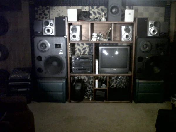

Just something to think about that I have found in the past.
I have a 5 pair speaker selector from a car stereo store install. I have 5 pairs hooked up.
What I realized is that was really not doing me much good as all of them were in the same room. Yes each pair sounded different, but the idea is more of getting out of the room you are recording in so that you are not fooled by what your room is telling you. Not necessarily the speakers themselves.
I don't use them at all anymore...
