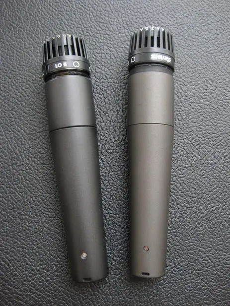

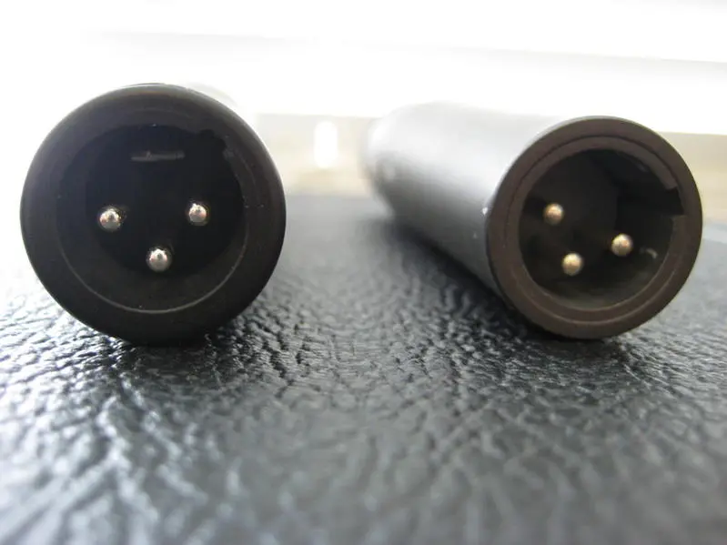

Well it's pretty hard to tell if it's a fake or not,... they're building them very close to the original..
One way to tell is by looking in where the mic cable hooks up... besides there being the 1,2&3 pins ..there should be a flat tab in there as well .... I believe that the fakes don't have this ....
The one on the Left in both pictures is the real one,...the one on the Right is a fake,....

Mine has the flat tab at the end of the mic, and it do has solidified glue holding the transformer.
