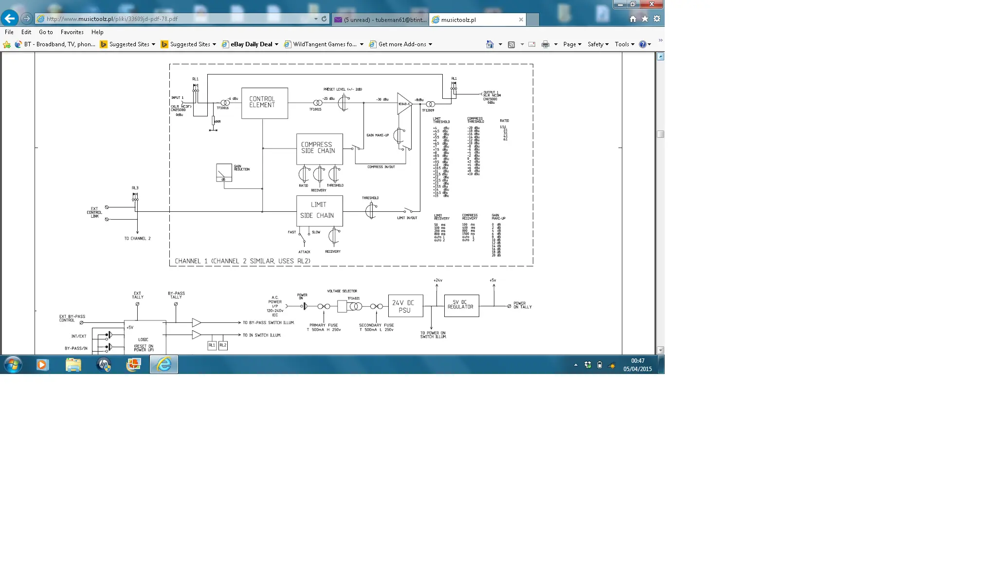

I have no access to any of this kit (and it wouldn't matter if I did from a sound "judgement" point of view!) so I base my observations on maker's speccs. Note that the Neve diagram shows quite clearly that the output amplifier is POST the compressor gain control element so changing that gain will have no effect upon the compression characteristics.
