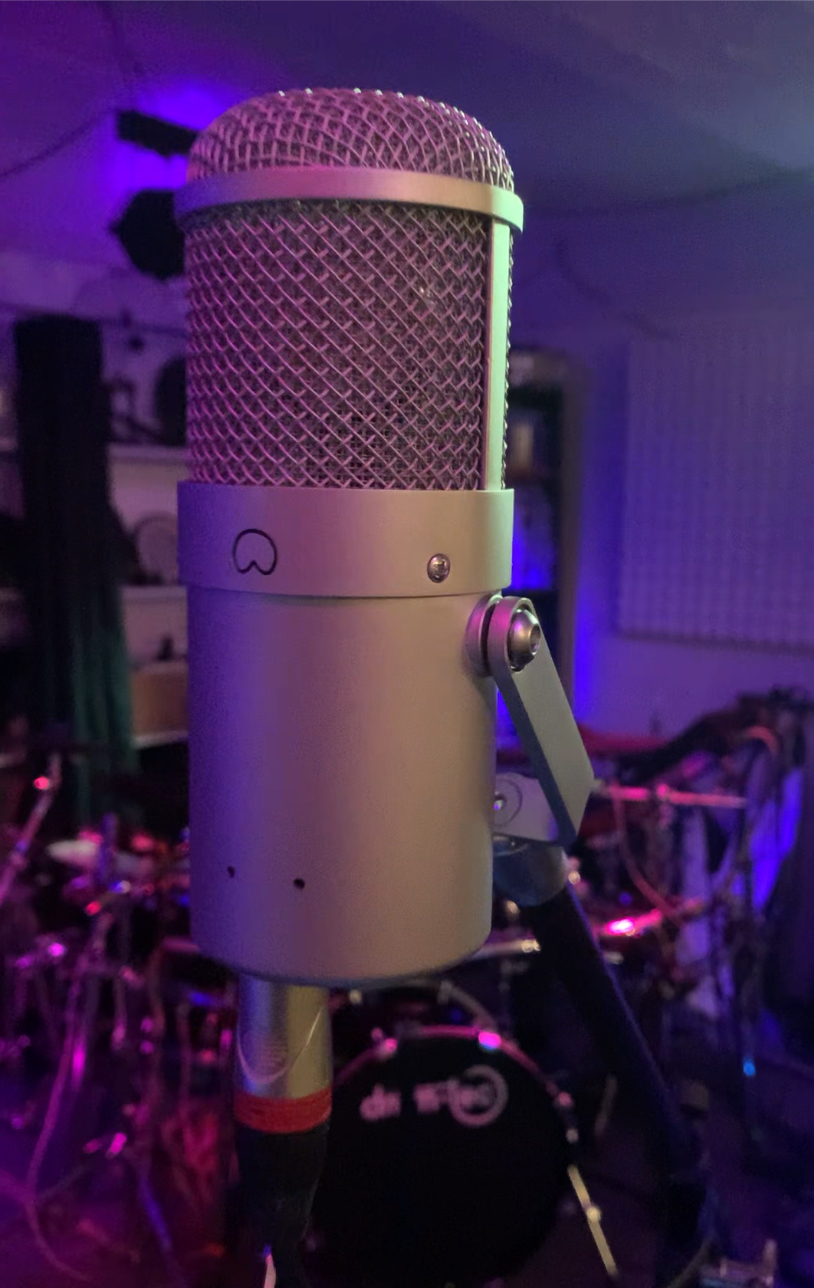

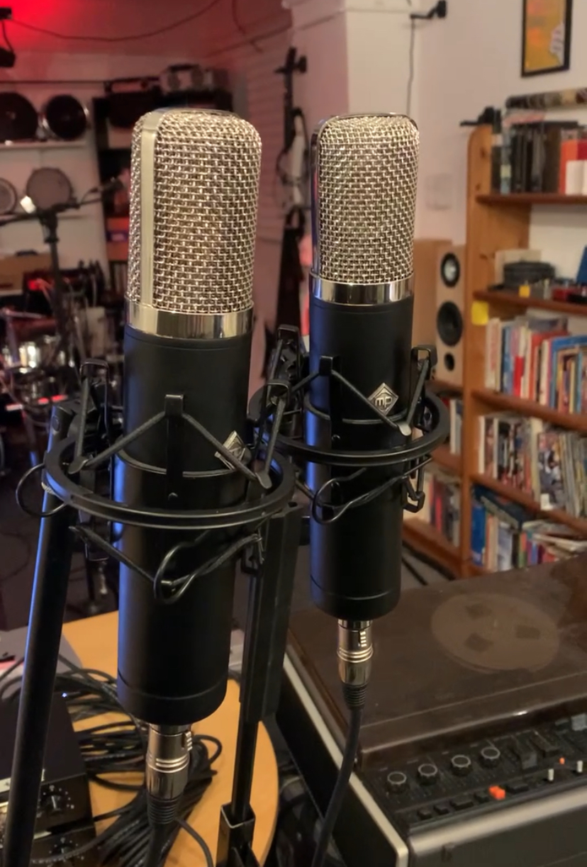

As a more general update: I finished building the FET47 yesterday and besides accidentaly wiring it as a omni first try, all three mics work great (see pictures attached). Met up with a lovely chap today and measured the first vintage U47 in the anechoic chamber today. Unfortunately I was so in the zone that I completely forgot to take pictures. It was his grandfathers who worked for the local broadcast, just like he did. He'd actually studied at my university and had used the chamber for his own builds 40 years ago, so we got on well and I'm thankfully allowed to lend it for the upcpming recording session.
