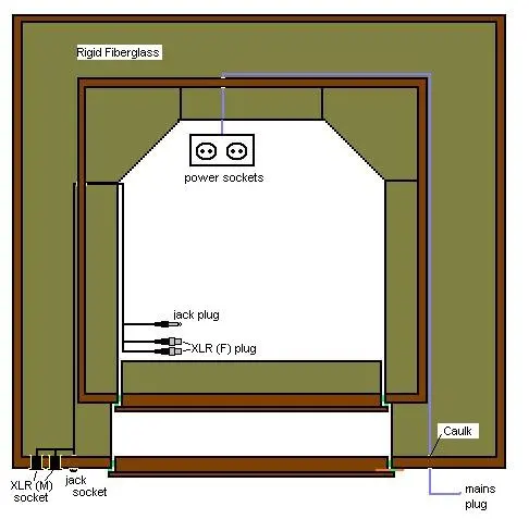

This is what i'd do: screw pieces of MDF with material covered rigid fiberglass together in a box(leaving 1 side for a door), glue rigid fiber glass to the other side from the material covered sides then build an outer layer of MDF around it. on the inner one have a removable door(not on a hinge), and the outer have a hinged door. Before you door all this though, you want to get all the plugs and sockets etc into place as shown on the diagram(don't need to be in those exact places). On the inside install 2 mini superchunk bass traps as shown.
Oh sweet, this is exactly what I was looking for! Tonight I'll do some reading on fiberglass, because that's something I don't know much about.
Did you draw these up, or did you find them somewhere? If you drew them, thank you very much! If you found them somewhere else, could you link me so I might find more information?
Also, do you have experience with this yourself? Is Blaze right about the burnt amp?
Yeah i drew them. I don't have experience with it myself, but do see that it could become an issue. I think it could be easily sorted though, with small fans such as computer fans or whatever. But obviously installing fans as ventilation will cause a drop in transmission loss, unless done properly. I'll leave it for someone else to explain this, because i am unsure.
