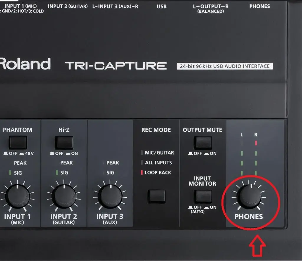

Dear,
I've been using Tri-capture Audio Interface for months. There's nothing to complain about it but since I change my headphone to another one with no volume controller on it then I realize that I can't control the volume to my headphone by the volume controller of the interface anymore. That means I just can control the volume of sound by the fader of Window or any music/software. Eventhough I turn the output of the Interface to zero, it still plays music with the volume that window provides.

I become to think that it's the hardware problem. Basically I can't use this analog control anymore

If your headphones are plugged into the PHONES output and that knob does not change the volume, then its a hardware problem. Sounds like its always been this way, but you never noticed it because your previous headphones had a volume control that you used instead? If its still under warranty, get it replaced!

Thank you :) I'll get it replaced :D
