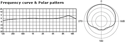

How far away from the mic are you? Try miking at 6" away, with pop filter.
The MXL992 has a pretty wide cardioid pattern (see attached pic), but close miking should still take a good bit of the room sound out, and will add bass and fullness due to proximity effect.
