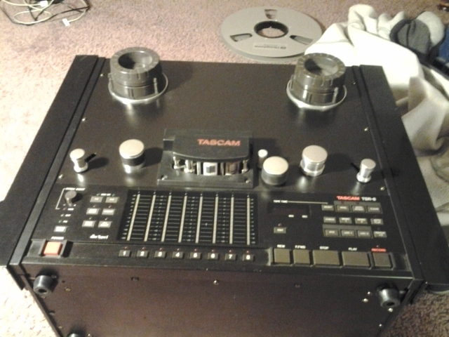

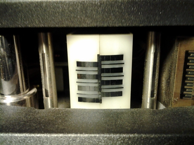

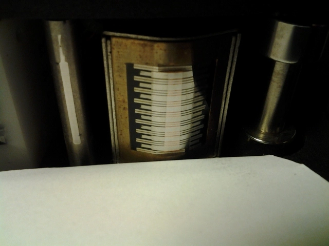

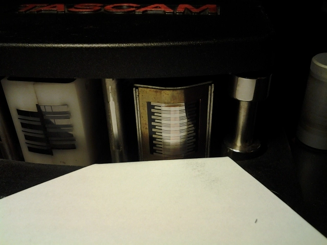

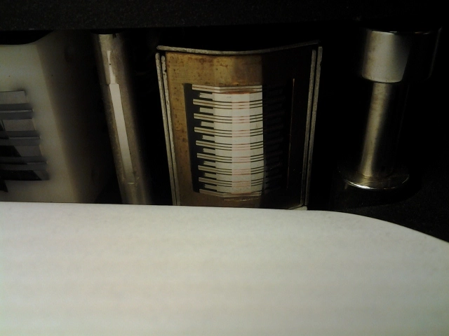

Hey guys... So I'm pretty excited about the TSR-8 I picked up a couple of hours ago from this quirky dude who went digital. It's extremely clean, but I don't exactly know about the heads. This is my first 1/2" machine, so, first-hand, I don't exactly know if there's a slight uneven wear pattern, or if it's a sort of optical illusion because I can't look at the heads exactly perpendicular. What do you guys think?

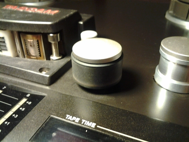

Everything else looks to be great... the capstan is is relatively clean (compared to my 34), the pinch roller is in great shape, and the tape path in general looks really clean. I'm not 100% sure about the heads... I attached some pictures of the heads, etc. Let me know what you guys think! I paid $450 for the machine, the hubs, two 8 cable RCA -> 1/4" snakes, and an empty reel. He said he had the manual, but he couldn't find it and would let me know if he did... He thought he was overcharging! I thought he was undercharging...

Looks pretty clean and whatever wear there is on the heads, guides and lifters, it seems to look pretty even which is good.
I didn't see you saying if you tested it to make sure all 8 channels record and play but hopefully the seller made some reasonable statements to you regarding that before you handed over your cash. $450 sounds like a pretty decent deal so long as everything is working.

Might be the angle but the head looks like it has more wear on the bottom edge towards the machine side? If so it will need realigment / adjustment so that the tape angle is exactly flat when hitting the head. The heads will need a relap at some stage if the problem is not dealt with within a few years.
Might be an idea to get the machine serviced now sooner than later IMO The machine looks in good condition however.
Yeah, that's what I was kind of thinking... it might be the angle, though. Hopefully it isn't anything serious. I will definitely get it serviced before I start using it - if anything to make sure it's set up for the right tape (and it's aligned properly, etc.). Thanks again for the comments guys!
