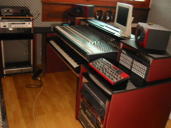

THe 2nd desktop rack is finished (still 2 borders to paint :( ).

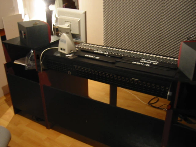

And, of course, the back ! :D
Looks Great!
The color scheme matches those Tannoys too. Good planning.
But, um.... I think you need to get those Tannoy's up off their sides and onto their ends.
I guess so... just on one side i have a window that would be partially blocked by the speaker, and it's summer, you know :D..
But I will put them upright during real use... :p
