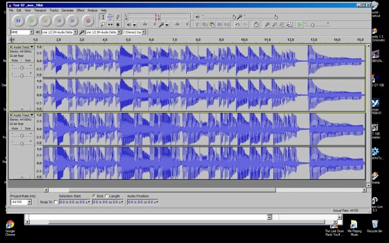

The only time I ran into a problem with distortion during playback through Audacity was when I had the audio track open and hit the Record button, at which point Audacity played the old track while recording it into a new track.
I had only intended on recording a new take using a blank track, but Audacity played the first track automatically and added a new stereo track to record to, so I let it go to see what it would do.
But accidentally re-recording it boosted the signal so that clipping occurred, even though no settings were touched by me to make it do so. (all I intended was to do a fresh recording of what I played earlier, using a new blank stereo track.)
(*the signal boost is visible in the screen capture: top stereo track is the original recording, bottom stereo track is the same track bogusly "re-recorded")
Is there a possibility that this is somehow happening to you?
Other than that, I am as stumped as you.
