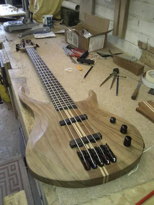

I don't like the look of them so I guess that is part of the reason I'd like a cap on there. There is nothing inherently wrong with the design but it can be a pia to put right if and when things do go wrong. Many basses still use neck thru as standard with no problem but I would always recommend some sort of laminated construction to give it stability. Not long ago I did a five string bass with a five piece laminate thru neck. Came out fine.
