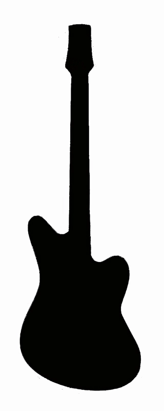

If someone could make a suggestion of a guitar to choose as a starting point for the surf design it would be helpful.
I'd start right here. Everything can change however, I always start by looking at silhouettes when deciding on body shape. It's less cluttered but still gives you a solid look..
Your silhouette looks very Jaguar/Jazzmaster. I really like it with the two sided headstock. I can do up the drawings I have posted in silhouette form if you can wait 'til tomorrow evening. Perhaps that will give some time for others to weigh in.
It is because it's the Jackson surfcaster, Just inverted and blacked out in photoshop. What we all really need here is drawings in a simple format that we can all play with. I'm no graphics expert so I have no idea where to start with that. As I say I'm still a pen and paper guy. One day I will learn CAD. Or so I keep promising myself..
