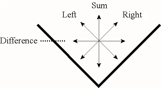

Except, I think he is wrong with the stereo aspect. The right and left side of the groove do not make up the right and left channels. The grrove is cut so the needle moves left and right AND up and down. The left/right motion is for one channel, the up/down motion is for the other channel.
How to pack a stereo signal in one record groove

Vertical motion is the sum channel, equivalent to the mid channel of a M-S mic array. Horizontal motion is the difference channel (like the M-S side channel). Diagonal movement is left or right channel.
When the stylus is moving only vertically the sound is the same in both speakers. When the stylus is moving only horizontally (rare) the sound comes from both speakers but the polarity is opposite, and on a surround system that signal will be directed to the rear speakers.

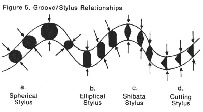

The "groove", in modern terms, is a un-equalized signal. They can't cut bass grooves full-on. When we used to sharpen our needles, there wasn't any bass to speak of. It was there on radio. My Heathkit preamp has something like three EQ curves for records ? The ceramic cartridge could do OK without out EQ - that's, typically, the needle with the flip arm.
So, the modern record is something like 3D without the 3D glasses. Even with RIAA EQ, the cannon grooves on the Telarc 1812 are kind of a marvel - with large lateral movement tossing the tonearm into the air, or, the heavier arm on a skid across a inch or two of adjacent grooves.
My Garrard Lab80 had a ceramic cartridge on it 'til 1972 when I got a Sure M-44e which is a magnetic cartridge and I then needed the RIAA EQ. Typically, a modern stylus doesn't contact much of the groove, but advanced designs are more like a pointy garden hoe - giving more contact to the groove. I've had the line contact/shibata types from Empire, AT, and Rega, and the old Rega R100 was my FAV. Get a good stylus !
