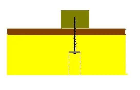

Not sure but I believe it will sag without the right support. You need a backing of 1/2 inch at the least to accomodate stapling fabric. Take a 4x8 sheet of plywood and rip it (cut with the grain) length wise in two pieces( ripping the wood in that direction makes the board stiffer and won't sag). You should be left with 2 - 2'x8' pieces.. The remaining two should then be cut into two equal pieces both 2'x4'. Makes four baffles
What I have depicted below is not written in stone. But I believe this is the best way to do it when it is on the ceiling and there is only one person doing the work and no one elso to help.
This way you do not have to glue it down.
1.Mount the 2x4's on the ceiling( if you cannnot find a stud use toggle bolts). Then screw the plywood to it. One screw in each corner.
Bore a hole half way through the fiber. The hole has to be big enough to accomodate a 1/8 - 1/4" fender washer. Screw 3" coarse thread screw through the center of your bored hole then through plywood and then into 2x4. see diagram
Staple and stretch fabric one side then the opposite side into the side of the plywood, folding the fabric under as you go along. This will create a finished look. Staple the remaining sides and the job is finished and you can tell all your friends you did it.
Remember there are other ways to do it. This is how I will do it
if ever decide to.
