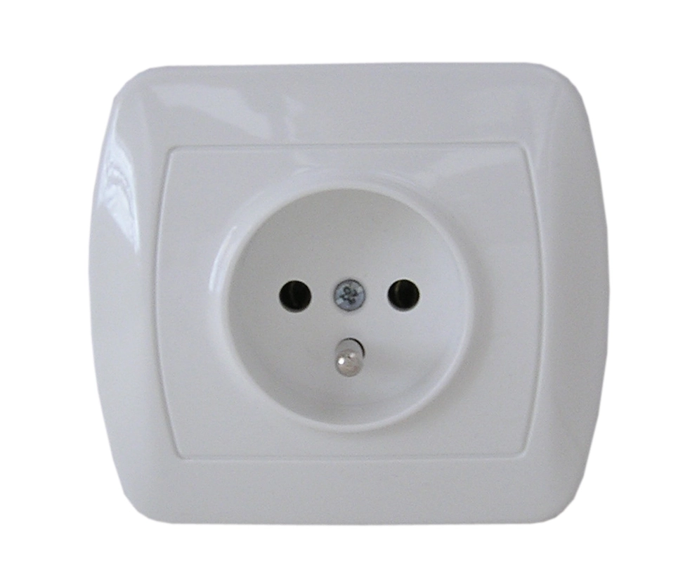

In most systems here, we no longer have "polarity". Symmetrical. But a hot ground would be noticed immediately, because ground connection protrude from the sockets:

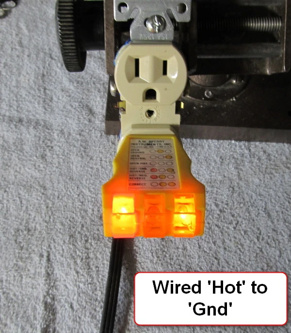

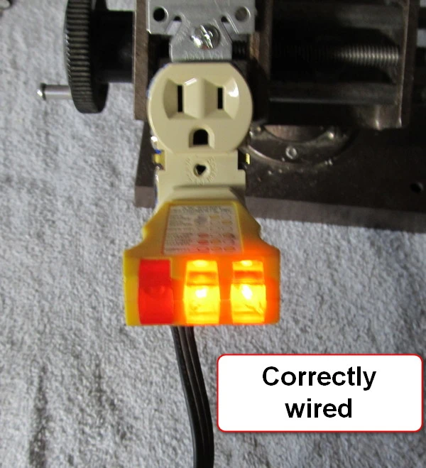

Curiosity got the best of me and I had to see if my $3 tester would see something amiss. The outlet on the right has the hot/live AC wired to the ground lug and the real ground and neutral to the 'blade' connections. Even if hot/live and neutral to the blades were reversed the tester indicates incorrect wiring. Just trying to understand how it could be mis-wired so the tester doesn't properly show incorrect wiring, at least on a typical US outlet.
Perhaps on the type of outlet you posted, having two live conductors (no neutral) and a ground could cause the tester to misread an improper connection(?)
Yeah...I'm not understanding it either...my $3 tester shows every possible miswired scenario...and of course, correct wiring.
