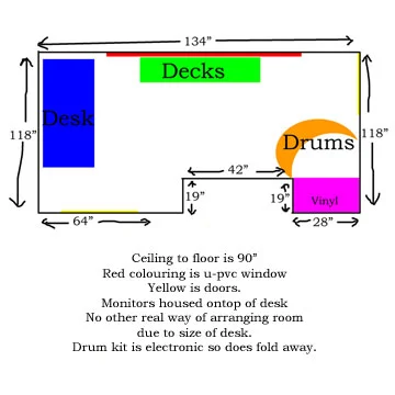

Ok thats a quick layout of my room with measurements in inches. The desk i have is custom built and as such wont go anywhere else in room without causing obstruction. If anyone can fill me it on what i should be lookin at here then please do.
The floor is wood, and as stated 90" from floor to ceiling.
Any help would be appreciated.

Hey mud.......wow, never called anyone mud :D Anyway, can you center your console on that wall. If so, I have a plan for ya. :)
Unfortunately i cant as it has a doorway next to it in which i will be placing 2 solid pine doors to help with a little sound leakage reduction into my living room lol....also to help block out the sounds of my daughter laughing and calling shrek all the time hehe.
Initially i was just gonna cover that with a partition but it aint gonna be able to happen now.
The desk/computer unit is self build in 3/4 cabinet grade ply and is 8ft long and 2ft deep. And to add to that, it's fookin uberheavy lol.
But anythin you could offer up may be a great help.
