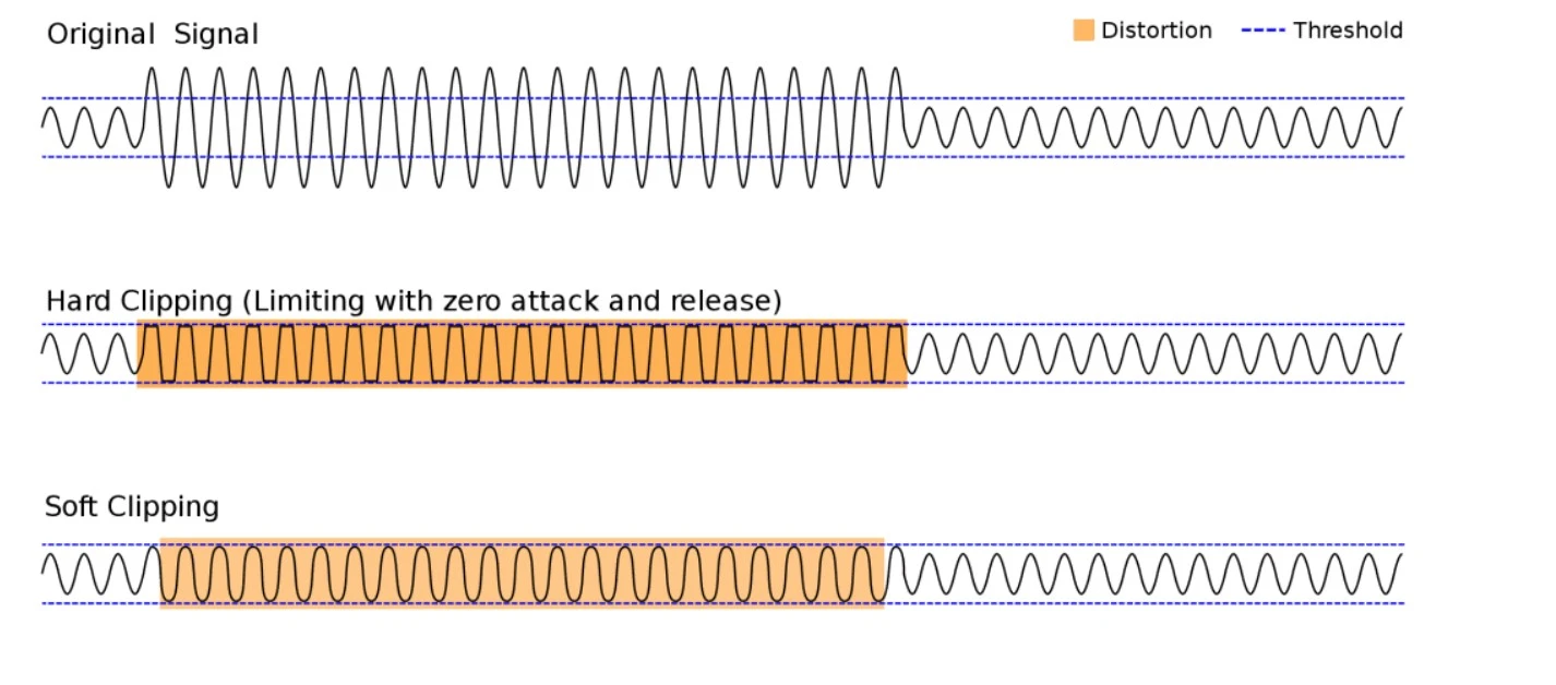

Get some visualizations going too.. Look at the amount of noise happening in the track. On top and bottom of the range. The middle is the goods you keep. If the middle has good movement, cut everything above and below that has unorganized noise.
look at this chart..
It is not needed.
Um, no, the top and bottom aren't noise, that's signal. Notice in that illustration that the clipping parts of the signal are highlighted to point out that it has been distorted. The plugin you showed does what's illustrated in the middle with the hard clipping.
hey man, I think its supposed to go with my HPF LPF comment. No, lets use it for both ways. Cause its probably the same? One way is dynamically clipped and the other is amplitudally clipped.
In the limiter video I linked it clearly states that there is no distortion from limiting.
Yeah, when the thredshold knob is dimed. Don't crank it , but use soft clipping within the same limits...bottom picture in chart.
Then the video is wrong or you misinterpreted it.
The plugin with the settings you showed will cause hard clipping in the plugin itself, and it will make it more likely to clip the converter.

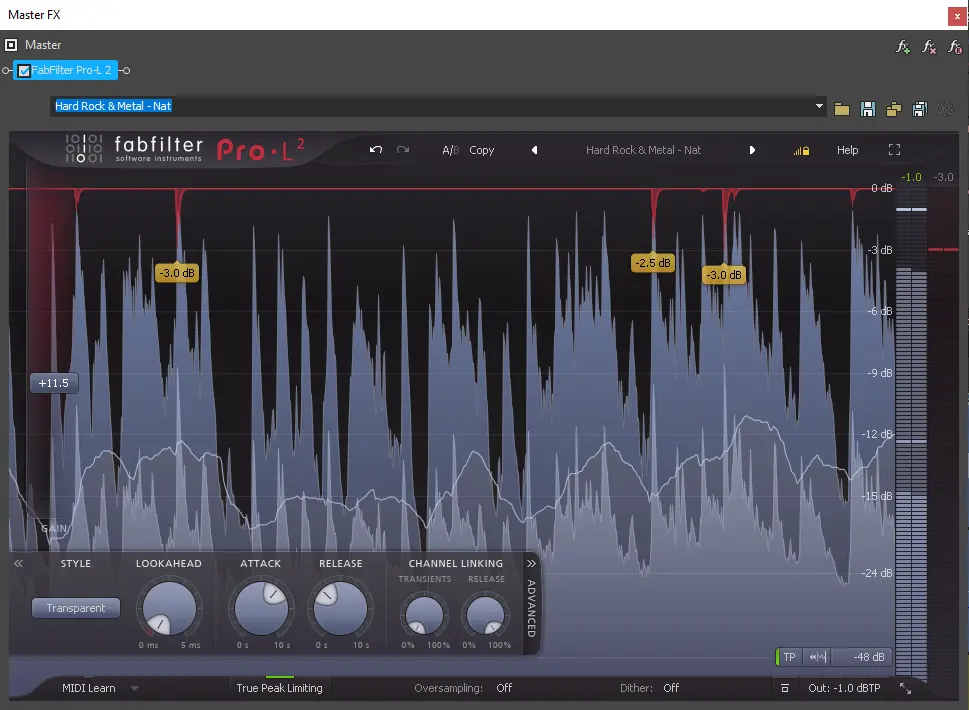

OMG, that whole video has distorted audio. It's not drastic, but it's pretty noticeable to me. On top of that, he has no clue how Pro-L works. He's not actually limiting anything, he's just adding gain. Here's what it should look like when it's actually limiting the signal. The dips in the top line represent gain reduction, and each dip has a label showing how much gain reduction is being applied at the deepest part of the dip. Don't take advice from the guy in that video.
