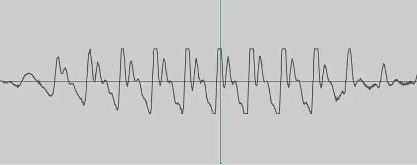

It's happening by turning it down after it's already clipped. Like this:

if you clip it at 0 dBFS and then turn it down 8 dB afterward, you end up with a clipped signal with - 8dBFS peaks.

Correct, you'll have a clipped signal with -9 dBFS peaks. See the pic I posted above. Peaking and clipping are different things.

Using that plugin with those settings actually causes clipping if the signal goes over the threshold. It's literally called a Limiter/Clipper. The flat tops of the waveform it produces are exactly the same as the flat tops of the waveform produced by hitting a converter too hard. And it's entirely possible to clip the converter then get more clipping with that plugin. You're not "limiting" the amount of clipping, you're practically guaranteeing that clipping occurs.
