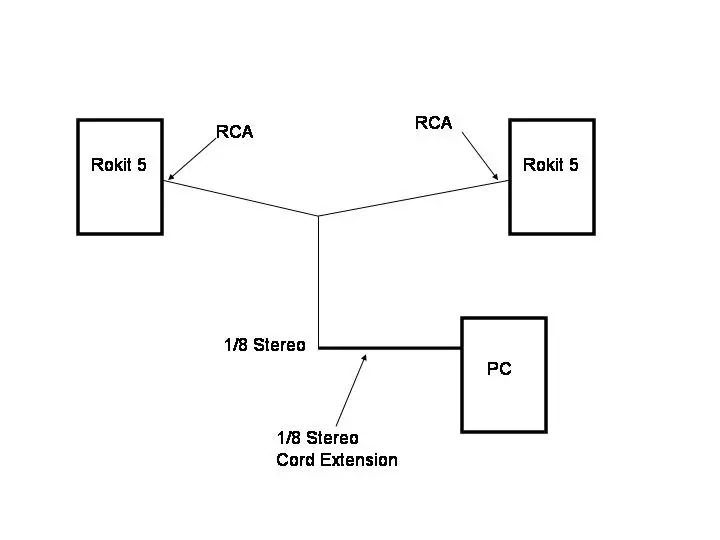

I have Rokit 5's. If you look at the picture I attached it shows how mine is layed out. The reason I ask is because I just recently hooked these up and as soon as a make the connection to the monitors, I can hear a constant hum. I made sure the volume on them and my computer wasn't set at max (which could produce that hum). I'm just wondering if I am missing the obvious or if I need a better sound card ( I have the one that came witht the computer).

Well there are a Few Reasons why you might experience a Humm in your Monitors the First being that your Sound card is Createing the Noise as many Cheapo sound Cards will Pick up the Electrical Noise from your Computer and other electronics....
Another reason could be that you are useing Non-Shielded Cables and you are Picking up interference...
You could also have a Grounding problem with one of the devices in your audio chain.....
Problem solved!!!!
Turns out I wasn't using good enough cables. My monitors are hooked up and I'm ready to go. Thanks for all the help!!!!
