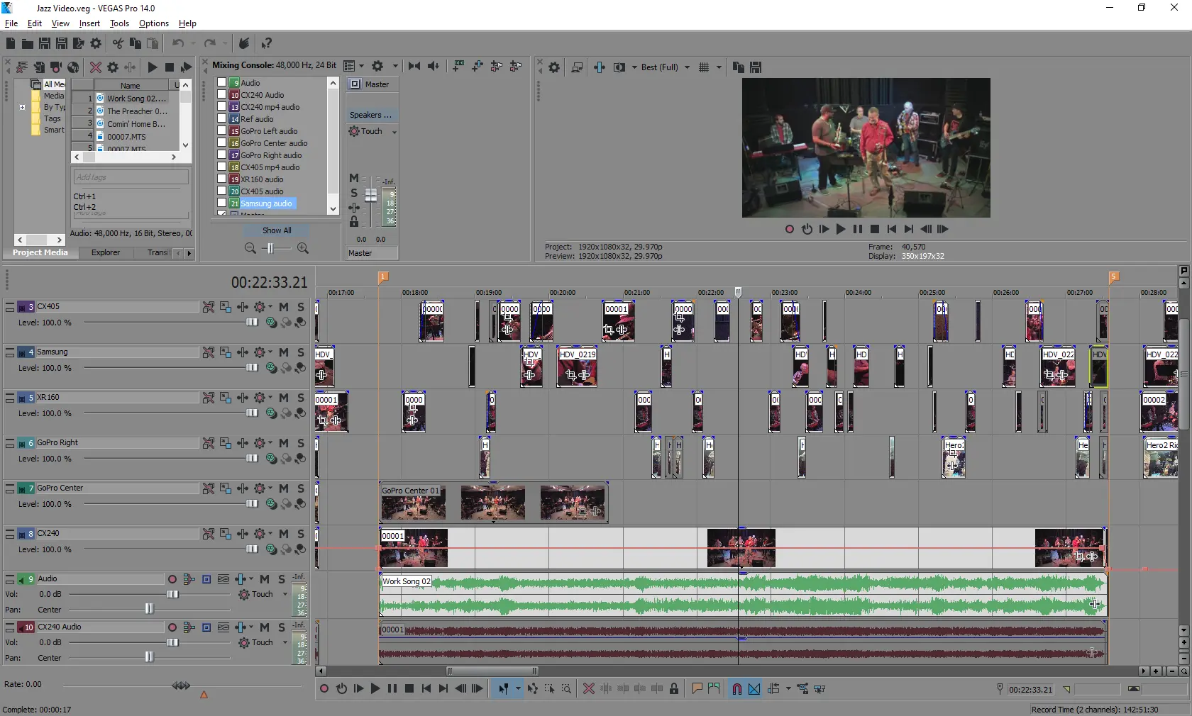

Your project would look like the three bottom tracks in the attached image. My project has multiple cameras so it has a bunch of extra tracks yours wouldn't have (unless you get more cameras). The relevant tracks are channels 8, 9, 10: video, the finished audio (mixed in a different project) and the camera mic audio.

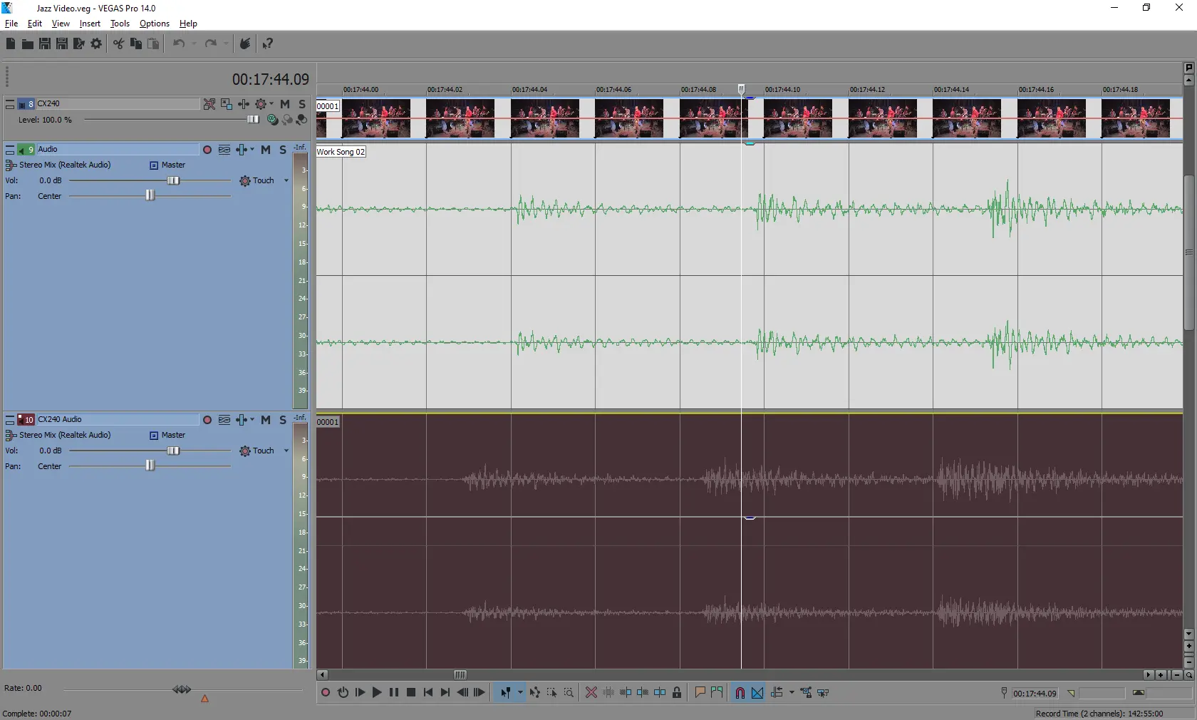

Syncing audio to video is pretty easy. You basically zoom in and match the good audio to the camera audio. But I like to fine tune the good audio against the video for optimum results. Sometimes the audio recorded with the video is slightly off from what look/sounds right to me. In the attached image you can see a slight offset (about equal to one frame or 1/30 second) between the good audio and the camera mic audio.
Here's a trick. You've probably seen film or video production depicted (in film or video) where they have that chalkboard with the thing on top that slaps down. It's called a clapper board. You can get the same effect just by clapping once on camera before the take. Then you'll have a visible (in the video and in both waveforms) and audible reference point you can easily match up, a sharp peak in both audio files.

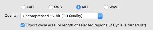

Keith Rogers. When I go to share and then export song to disk there are options coming up. ACC, MP3 and AIFF and then 4 quality options in the quality drop down. Which ones should I choose? There is also a box underneath that says export cycle area or length of selected regions (if cycle is turned off) Should I tick this box? Also how do I physically remove the audio from the video and replace it with the garageband one?
I'm finding that the audio from the mobile video sounds significantly louder than the garageband file which sounds way too quiet and there doesnt seem to be a way of turning it up. It's odd because when I listen to the garageband file with headphones on through the focusrite interface it's much louder. Any suggestions?

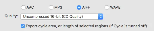

I would export it as 16-bit AIFF.

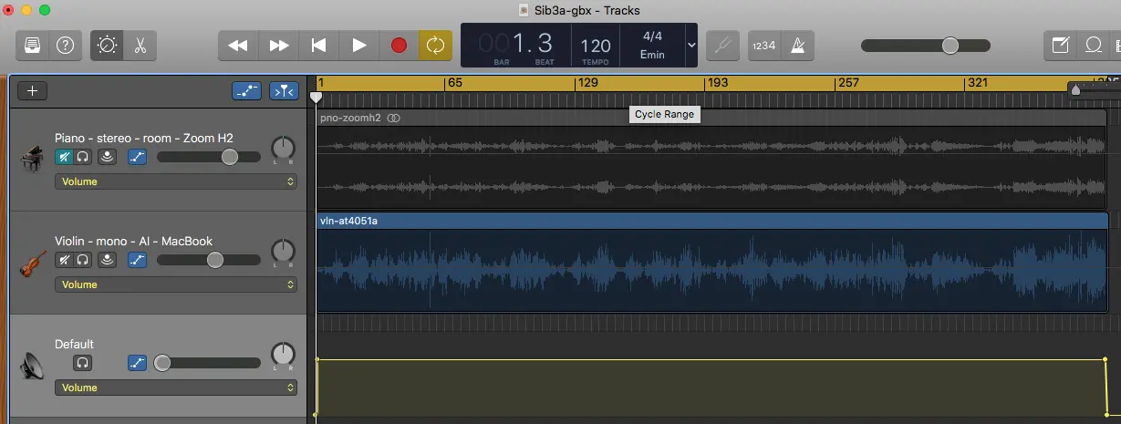

The cycle range is denoted by the the very top bar in the track/mixing window. You set that if you are creating a loop, or if you want to control the start and stop of the exported song. I always use it, setting the ends a bit before and after the song start/stop. Then, you can use automation in the master track to set a fade in/out (or completely zero levels) so any stray recording noises are minimized. If you don't set the cycle region, don't check the box.

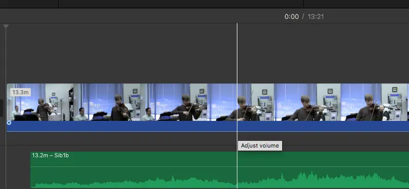

In iMovie, you make sure the audio track is shown in the imported video, and reduce its volume to zero by dragging down the level.
I've attached some screen clips of those spots.
P.S. (Edit) If you have *no* cycle region highlighted, and have trimmed your song's regions to just what you want to hear, you can select those, and use the checkbox so only that amount of audio will be exported. Otherwise it [probably] exports the entire project, which will include all space before and after the regions.
